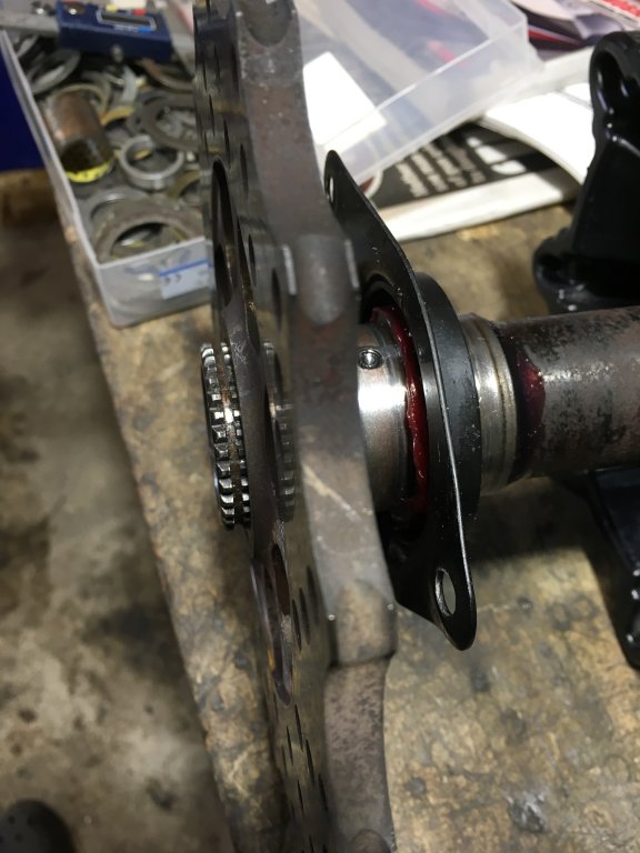

I'm thinking of doing the same thing.View attachment 148643 View attachment 148642 Question shim brake rotor disk to tighten up ?
Or let it float ? Thoughts ?
gpxsrx where did you find that shim ?

The shim is not the right size just for reference in picture. But reading more on topic in sidewinder section.I'm thinking of doing the same thing.

https://ty4stroke.com/threads/barn-of-parts-potential-drive-shaft-bearing-lock.156732/
So rotor should not float. Will have to source a shim to tighten up.

Never used loctight hoping for the best set screws tightened up nice and snug.

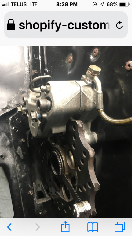

View attachment 148647 I just checked rotor installed with calliper installed and I need 0.037 shim washer to take up play.
I have not put mine back together yet (still waiting to get my shaft back from the machinist) but bought a Koyo AS4565 thrust washer. It's designed purpose is to be a race for a thrust bearing so it is hardened which is nice, it also has the same 45mm bore as your bearing so it will fit nice on the shaft. 1mm thick or .0394" so you should be able to squeeze it in there. I am going to put mine behind the rotor (between the rotor and bearing) because the inner race of my bearing wore a groove in the rotor from spinning on the shaft. You can buy them online or pick one up at your local bearing distibutor. https://www.motionindustries.com/productDetail.jsp?sku=00093070

Thank you very much saves me getting my machinist to make me one. Good find. Have a good one. ThanksI have not put mine back together yet (still waiting to get my shaft back from the machinist) but bought a Koyo AS4565 thrust washer. It's designed purpose is to be a race for a thrust bearing so it is hardened which is nice, it also has the same 45mm bore as your bearing so it will fit nice on the shaft. 1mm thick or .0394" so you should be able to squeeze it in there. I am going to put mine behind the rotor (between the rotor and bearing) because the inner race of my bearing wore a groove in the rotor from spinning on the shaft. You can buy them online or pick one up at your local bearing distibutor. https://www.motionindustries.com/productDetail.jsp?sku=00093070
Just remember there has been cases of the snapring coming off. Probably from a seized Caliper piston. New style and old.
