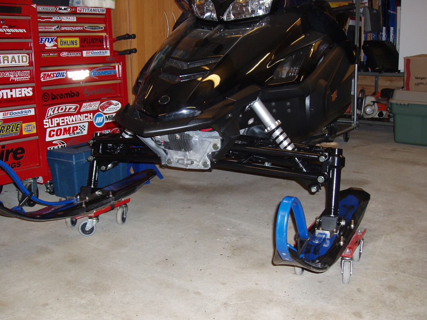

Just got my front end back from powder coating. Ulmer's bushings all installed. Really tightened up the front end.

I also used Ulmers kit and added grease zirks to the A-arms.
Ulmers kit worked perfectly and has lasted great!
Very pleased.
Another RX with Ulmer front end bushings! Really tightened up the front end and an excuse to powdercoat everything.
