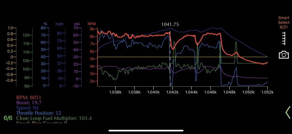

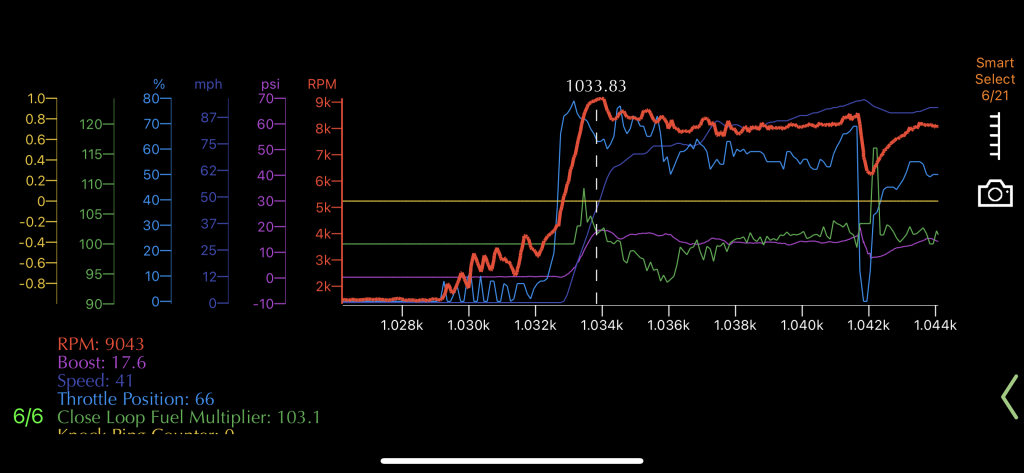

Could show the log with boost, rpm, throttle, speed, and fuel multiplier? If you want to play the bonus round, turn on knock ping counter as well.
ps. - you live in Indiana and have your speed in metric?! There is only one unit for measuring speed, and that is MPH!
lol fixed! Knock counter is the flat 0 line.

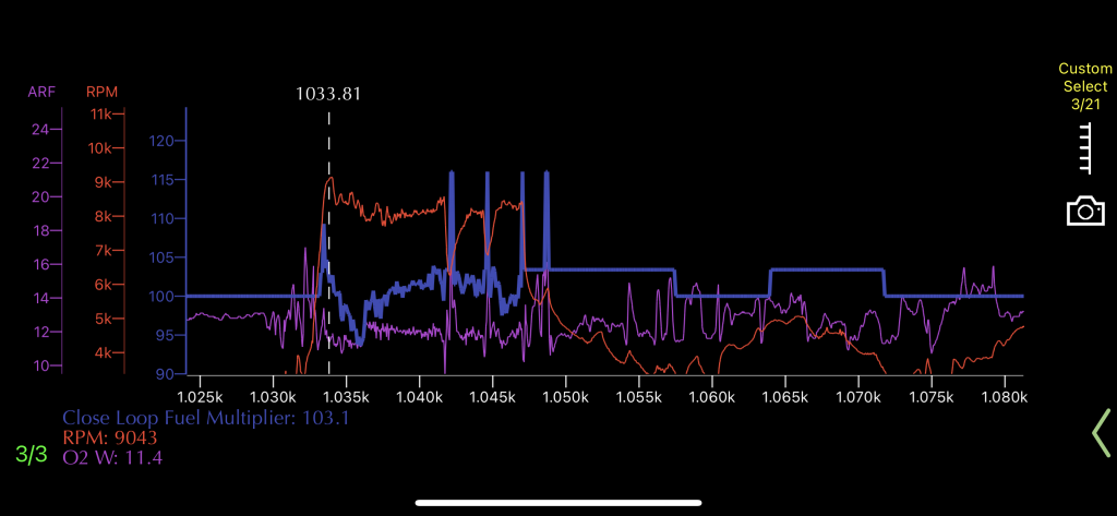

Looks like your tune and fuel pressure matches good. Your staying around 100. See how the auto tune shuts off at lower rpm... it does not activate until a certain speed. This data logging is great.I don't know enough to answer that question, so I'll just post a screenshot example. For the fuel multiplier number, it fluctuates 98-105 roughly and sometimes spikes higher up to 116. But, I don't know what that means...
