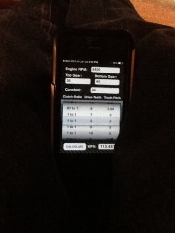

Using the gearing calculator app, your combo on the 15 is 113 mph without overdrive at 8450. OD would get you that extra 5 mph. based on your setup pulling 8450 and overdrive, it looks like you are right on the numbers.On my 14 XTX stock gearing with 252 ish hp and overdrive 112 was the best ever on an ice track at 9150 rpms. On the 15 at low boost about 230 ish hp and stock 3.0 drivers, overdrive and 26/44 gears I have seen 118 on the trail. it is clutched for high boost so I was only turning 8450 rpms. the chart says 134 mph for that and I do not believe if I got to run full high boost and was on ice that I would do better than 124 ish so I have little faith in the estimated speeds on the chart.
What the actual link for that app? CoolUsing the gearing calculator app, your combo on the 15 is 113 mph without overdrive at 8450. OD would get you that extra 5 mph. based on your setup pulling 8450 and overdrive, it looks like you are right on the numbers.

Go to the Apple App Store and search Snowmobile Speed Calculator.What the actual link for that app? Cool
