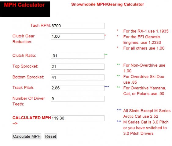

Even at 21/41 with 9 tooth at 8700 rpms at .91OD....its only 119mph. Seems like it should be geared way higher.
I also assumed the new OD clutching would be more then .91, since BRP is typically .85

Specs on the cat page are wrong. 24/50 is the 141 inch version. 21/41 is apparently correct. The Yamaha version will have overdrive more comparable to a doo at close to .85 apparently. Should net 120s.
