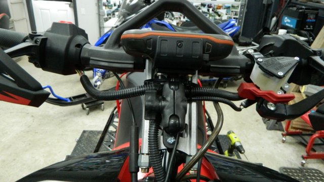

I mounted mine directly to the back side of the riser.
Anywhere forward of it and I hit it on the climbs locking the screen up. Anywhere on the dash they usually shake so much it is hard to read. I can easily see the gauges over it from a sitting position.
It is a 4" Garmin Montana.

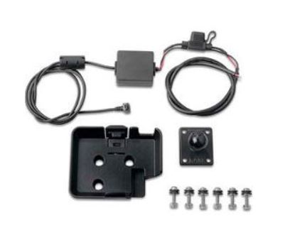

Next weekend I can get some pics for you up close on the mount as I am switching windshields and this area will be in clear view. I did it last year so the details are a bit fuzzy. If I recall it was the RAM 1" ball diamond base with either the double socket arm or short double socket arm. The cradle is a Garmin kit that comes with the power cable, see pic. The base is mounted with small bolts through the plastic dash in front of the gauges.

Wavemaster, a very nice mount for the Montana. I am looking at the Montana for my Viper as well. Can you give us the mount details? Is it a RAM mount; what base did you use and how is it secured to the riser? Would love to have the information so I can get mine ready to go!View attachment 100042

Ram mount
Small 2 screw base
Short extension
I drilled the bottom hole and went through an existing opening in the riser for the top screw. I used a backer plate behind (inside riser) to screw into. Then I zip tied it tight to ensure it would not vibrate or shake independently from the riser.
On mine I powered it full time so it will always be on regardless of the ignition, this way you can start and stop without needing to boot it up also it will keep the backlight on for maximum low temp use and to keep precipitation from freezing on it.
I love the Montana - with the ability to save multiple profiles (snowmobile, motorcycle, quad etc) and the maps that go with them it is hands down the best unit for me. Pricey, but good.

Very nice; neat install, and should be in a perfect position for riding. Thanks for the picture and details, that will be very helpful, and I anticipate duplicating your work!Ram mount

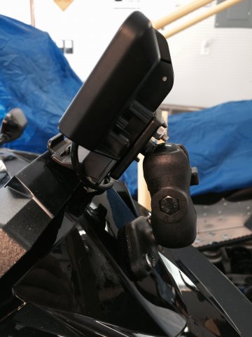

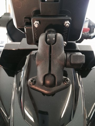

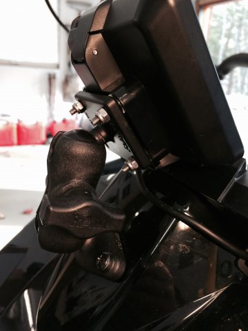

Here are some close up pics of the mount. You need to shim the diamond base mount with a small washer as a spacer as the mount will ride on the ridge of the plastic.
