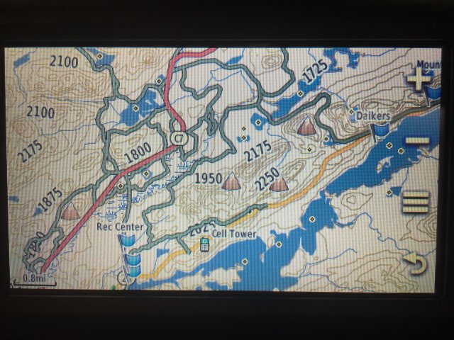

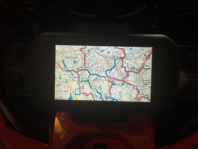

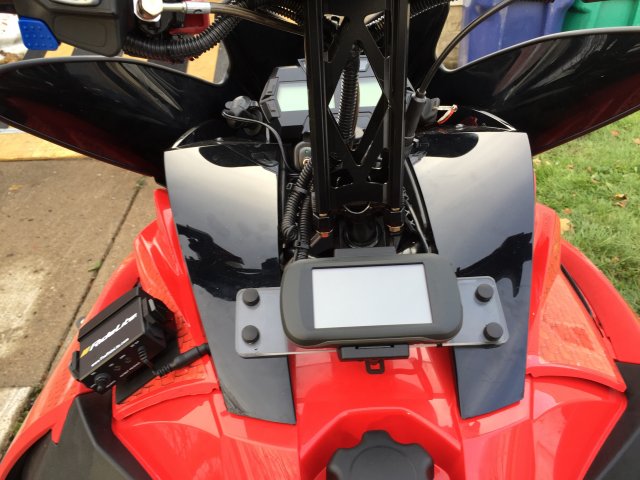

Here is my setup. It is a Montana 650T with red pine trail maps installed. What I ended up doing was using a 1 into 3 dc plug to keep things simple and to be able to quick release everything instead of hardwiring it. It powers the GPS, helmet visor and ride lite safety light with no issues. I also bought the Montana DC mount and wired a plug onto it to be able to plug in to the 1-3 adaptor. Looks good and keeps everything clean. I used 1/4" lexan to mount it to the sled and used rubber expanding grommets to secure it to the plastics but also utilize the rubber mounting for harmonic reduction so it doesn't vibrate creating a blurry screen when trying to look at it when sled is running.

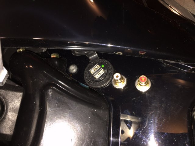

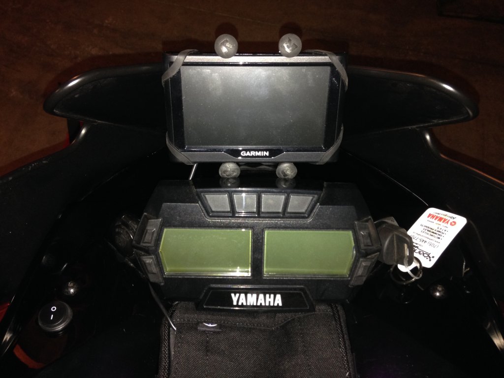

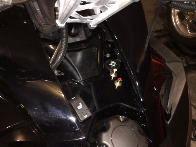

Here is my mount, on the dash next to the gauge pod. I installed a USB outlet to connect it to... and some outlets for the helmet heater.

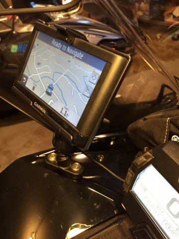

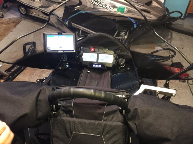

Nuvi 50 on a handlebar ram mount. Just used some big fender washers on the underside for more support and ran a dedicated line from battery into google bag. Nice and easy to see at a glance sitting or standing.
