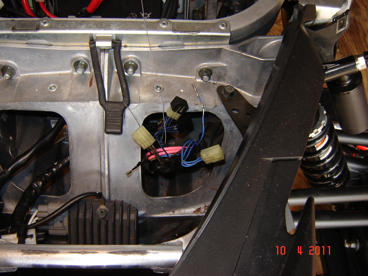

Went to start it today and all i got was clicking at the starter silenoid. Took light pod off and air box to see if fuse is blown and find a rodent nest in the front of the machine. after cleaning it out found it had chewed some of the wires. Theres a grounding block and 2 other similar blocks and then another similar block with 4 wires going into it but its flat. one wire chewed threw on the none grounding block and 2 chewed threw on the grounding block. Got everything spliced back together and and sodered electric taped. put some dielectric grease on the 6 prong pins so they wouldn't corrode like other blocks similar have on me.
Put it all back together without the light pod on and went to start it and it kicked a couple of times started then cut out on a couple cylinders and quit.
Rechecked everything and forgot to hook the wire back up to the oil tank.
Put the light pod on to see if i could get a code and tried it again.Only fires on one cylinder. pulled all plugs and all but 1 was dry so i replaced with new plug and tried again. fired on 1 maybe 2 cylinders but nothing. No code but when i turn ignition on the red light comes on to indicate cold and the yellow light comes on to indicate low fuel then after a couple seconds the yellow light goes out and i gain a bar on the fuel. Turn the key and the hole time its turning over the yellow light is on and the engine symbol is on. Still know code. fusses are fine and i can't see any other chewed wires. Still know codes.
Any Ideas????
I threw a couple of pictures on of where the little b#@$%#d made his nest and the wires

I would look over the hole area they ted. To eat more then you can see. Did you look for a short somewhere.
know ,can't find any more chewed wires. Is it possible something got fried while i was trying to start or when the wires where severed. I couldn't find any arcing on the wires or chassy.
Any suggestions where to start.

Since riding is done and you got nothing but time, Id say a good spot to begin would be to contact a used parts dealer (some places near Toronto are good, BTSP near northbay, and LANEO off this site) and see if you can completely replace that segment of cable, including all the connnectors etc..
Also, im assuming that the rodents nest is a recent event? If thats the case, and if you didnt already check, there might be more activity in your airbox or in the exhaust (to a lesser extent)

Ya I've checked everywhere for more damage including the air box,but not the exhaust. Running the codes on the self diagnostic mode the other day some old codes came up and a new one for the cylinder position sensor as well as code 50 not showing up at all which points to the E.C.U. as per the manual.
From the wiring diagram it looks like he hit the section of the harness that covers a bunch of the FI stuff. Will find the post on the stator.and check.
