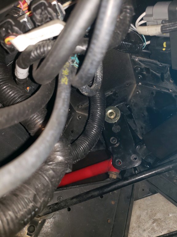

Between the fwd lower a arm mounts there is a hole for alignment. It will center up with the bellcrank / handlebars. This will keep handlebars straight and then only adjustment is on tie rods.
Here is some pics with the bellcrank removed and installed, the hole is about the size of a #3 screwdriver.
- 3,067
The nose plastic will need to be removed to access this alignment hole from the bottom.
