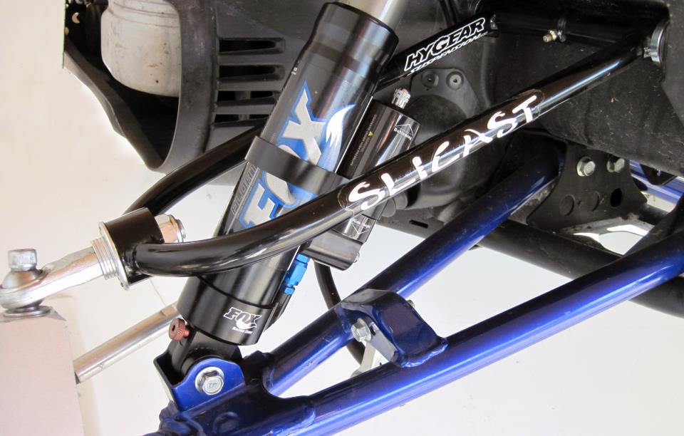

Since I have the regular floats they would cost me $415 from Fox to have them turn them into Evol styles. Which would be about the same from Hygear if they add their chamber, the internal spacer, and the anti-bottoming to the float. What is interesting is they are coming out with this. Saw it on their facebook page. It is their upper a-arm kit which is adjustable. The price also sounds interesting also.... Their tech said some rear parts are being worked on also, but doesn't know if they will be ready yet for snow time. There is a waiting list for the front parts he said

I have a set of the hygear air control chambers that came off my fox float X that was on my 2010 rtx se I will sell them to you for a reduced price. I am still using the floats in a 42" skins front end but I couldnt use the extra air chambers, I had clearance issues withe the a-arms with the x shocks but if you are using regular floats u could still use chambers with skins a- arms.

i used nextech resi's on my floats for my attak. They help out big time in the stutters. The increase of air volume lets the shock work more linear thru its travel. You can also run lower air pressure for a better ride and lower stance. Fett cans are to small IMHO.
