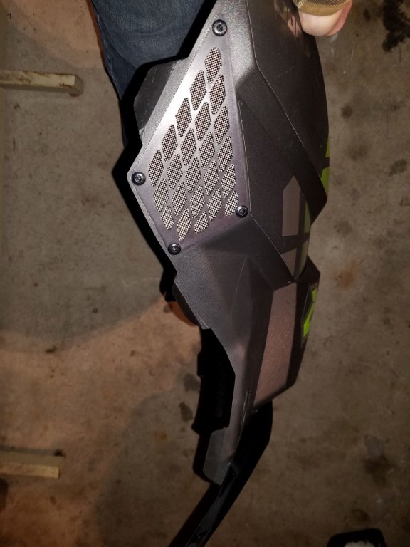

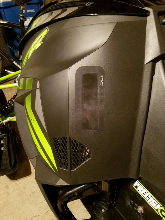

I added some additional venting both to front side and rear of panels. I'm always amazed at how much heat is coming out of the rear vents. I can feel it cooking my legs. LOL

What did you put for extra venting on exhaust side front/back? Do you feel it helped? Have any pictures. Just looking for idea's. thanks9,250? Is that where that tune's peak HP is? (My Stage 4 PEFI tune (PM) peaks at 8900. If I were to run 9250 I'd be down about 6 HP already).

I just feel like it can't hurt, right? Again, you should feel how hot the heat is coming out of the rear vents. First of all, I heat-insulated everything I could (on exhaust side) to keep exhaust heat out (of engine and even oil lines) to begin with. You can get this adhesive-backed product from most auto parts stores. Will stand up to 2000 degF. Note I put it on magneto cover, oil lines, oil tank, etc. Again, want to keep muffler heat out of anything I can. Then I added side-panel vent in front and rear.

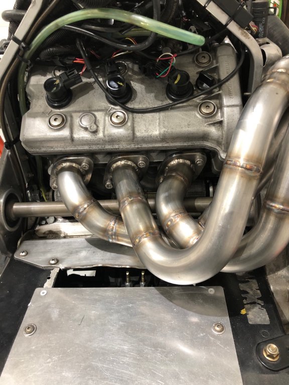

That’s awesome nice work! Looking forward to seeing the final product!
Welded and wrapped, just needs a heat shield and I’m done!

View attachment 152888 View attachment 152889
Nicely done that is awesome!
