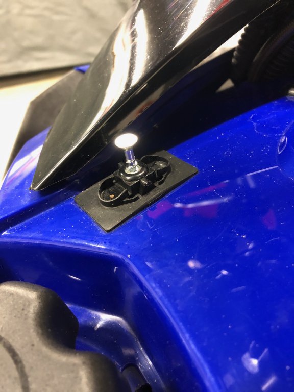

Some I just lost the rocker switch for my heated seat...just popped off I guess. I got looking online for a replacement and it seems as though I have to buy the complete switch which is around $80 CA. Has anybody installed a different switch instead? Kinda pricey just to replace the switch. Thanks

Not sure I believe it but someone said it’s a special switch because the resistors for high and low are in it and not two separate grids.
RAMSOMAIR
Perfect! Another wood screw. Why not!
RAMSOMAIR
Better than a Torx lol.
I just bought another switch off Amazon for $8 and put the top rocker on my heated switch.....Iztor marine rocker switch.

Well, I just went for a drive and bought a new switch for $80!!! Unreal. Just seeing all these messages now, how well does the wood screw work? Lol

Was just trying to find this with no luck, do you have a link?I just bought another switch off Amazon for $8 and put the top rocker on my heated switch.....Iztor marine rocker switch.

Just found one, maybe the lights will work. But I doubt it. I guess I’m making a trip back to the cat dealer

I think you can get parts for that switch. From terminal supply co.

I have some of the marine ones. The lights wont work and that switch wont work without resisters. That being said, pop the top off and stick it on your existing switch and you are good to go.
Sorry no link. I bought it back in Oct. I am sure andWas just trying to find this with no luck, do you have a link?
Sorry no link. Look around for any 3 way rocker, pop the top off and see if it will work.Was just trying to find this with no luck, do you have a link?
