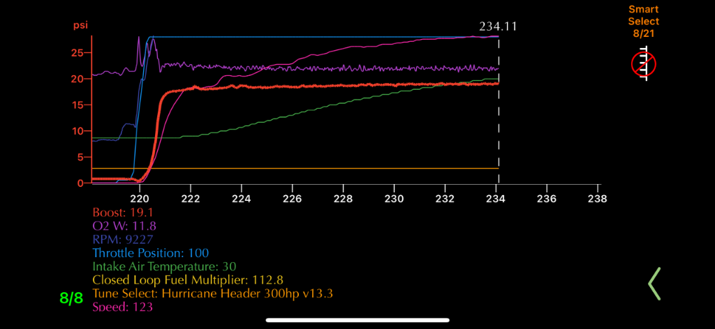

What muffler are you running? Do you run a cold air intake?As my data log shows my sled makes just over 19 psi boost as well...lol....just 30 mph slower then you "Mach Run Masters"
Just the 300hp header tune, no wastegate or turbo mods on my SW as well.

Just curious, your AFR is safe 11.8 but your fuel multiplier is 112.8Here's one of my data logs...lol...no where near the speeds Fleecer or other members have run.

Just curious, on this log, your AFR is a safe 11.8 but your fuel multiplier is 112.8. Does that mean ECU is adding 12% to maintain target AFR? How much can it add? What is limit for multiplier? Or is there no limit?Here's one of my data logs...lol...no where near the speeds Fleecer or other members have run.

Is the goal to try and keep multiplier close to zero? I assume that means adding or subtracting fuel pressure?
The closed loop is obviously auto tuning the fuel to match Hurricanes target AFR for the 300 header tune. Without closed loop my sled would be running lean. I already have the fuel pressure raised from stock 43 psi key on to 48 psi key on. From what I have seen on my logs, the closed loop will add close to 25 % more fuel if required to meet the tunes Target AFR as mine was doing that and indicating higher AFRs prior to me raising the fuel pressure. Dave at Hurricane as well as Mike Knapp have indicated my sled is a bit of an anomaly with the boost it produces with the header and required fuel to meet the target safe AFR so it may not be typical. Obviously equipment changes and weather conditions have a bearing on the sleds fuel requirements differences from the vendors baseline parmeters and that is one of the reasons I am a big fan of the closed loop system.Just curious, your AFR is safe 11.8 but your fuel multiplier is 112.8

As a side note....since adding the header, the Hurricane header tunes, and closed loop I have never seen dash flash detonation warning.

Jon, Bob has shared his logs with me and basically his sled is a freak out East like this, he also has hard parts on the machine the tune was not designed for, you know how that goes... It pulls more boost and makes more power than the average machine would out here in MN. He lives on the Eastern side of the country, and I know from my racing days that when you get beyond Michigan and especially when you get into the eastern seaboard, the air gets really good out there. Machines just plain go quicker and faster. Ultimately they pickup 2 tenths on the timers in 660 foot when you tune for the better air. They are closer to sea level and I also suspect they air has more oxygen content out there too, not sure exactly what it is, but every time I got into the main part of MI or further east, I'd have to really richen things up and throw a bit of clutch to a machine for the better air vs running in MN or WI area of the country. I've also had people come from out east to test with me on my timers here and wonder where their performance went as they were down 2 tenths or more here at home. One fella was running a 1250 Hooper Cat or some big engine, and couldn't understand why it was so slow here off the trailer, after testing with him for the whole day I got his 2 tenths + back in worse air, but he wore the engine out in the process, The pistons and rings were shot! the exhaust ports were so wide they ate the rings up and wore the edges of the exhaust port with up by the end of the day! Not what Id call od design build on that engine by any means. Regardless, he just couldn't get it thru his head that coming West would have lost him 2 + tenths. Exactly the reason that when we went racing East of WI I'd go a week early to dial in for the better air conditions. It cost me a race the first time I went to MI racing, and I just couldn't wrap my head around why I was so lean and couldn't feed the engine enough fuel or what was so different in MI and further East. From that point on I swore it wouldn't happen again and a week of testing was needed when going East. There is just something so good in the air out East, I think because it contains more oxygen from the trees or something.
Just goes to show how important data logging is to see how things are working when have parts on the sled it wasn't designed with or designed for when living on the ragged edge.

TF,
My other sled has closed loop and can add up to 125% or subtract 20%.
Yes, when setting the FPR, you aim for 100% and let the system add or pull % based on varying temperatures. I'm assuming it works the same for Hurricane Tuning.
I've had an O2 sensor let go, which puts the system in failsafe mode and an AFR of 8. This condition will peg the closed loop at 125%. One can always disable the closed loop with a flasher and go back to running the FPR manually if in a long trip and replacement sensor not available.

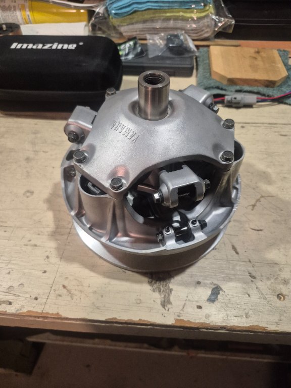

Fleecer, I've purchased an RX1 primary, and I'd like to do as you say, verify operation & machine for overdrive.
If everything on the primary works as it should, I've been reviewing/considering getting the primary cryogenic therapy to enhance its rigidity

Nice looking RX-1 primary that you have there.Fleecer, I've purchased an RX1 primary, and I'd like to do as you say, verify operation & machine for overdrive.

Yeah, its one of those, "diamond in the rough" scenarios. Just couldn't walk away from this one.Nice looking RX-1 primary that you have there.

I recently bought 2 new Yamaha OEM "clutch repair kits" which are pretty much complete primary clutches for 16+ Viper, Venture, Vector, etc... but disassembled. I also run a 12 Vector primary on my 17 LTX SE, a 16 Viper primary on our 1st 25 LTX LE, and will be putting one of the "repair kit" primaries on the 2nd 25 LTX LE. All have Thunder Products overdrive cut.Yeah, its one of those, "diamond in the rough" scenarios. Just couldn't walk away from this one.
I also have a couple other spare Japan clutches.

I can't speak to Cryogenic Therapy? Last I heard, Walt Disney did that and he hasn't woken up yet!!
Wow.....the clutch in your pic sure is beautiful! A power hungry tuner like yourself should probably cut to the chase and get a TAPP?? If so, I'll buy that clutch in the pic!!
