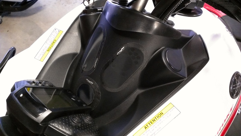

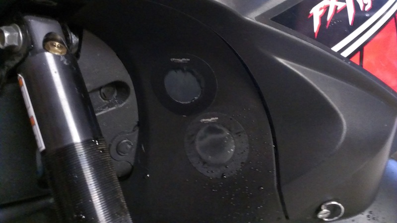

Just ordered the frog skins for the top of sled near gauges to release some of the heat build up in the engine compartment. Gonns make a few holes possibly in the top plastic and cover with frogzskins. Ordered the triangle and 3 inch round to see what looks better.
Been thinking of using the round one inplace of the Yamaha emblems on the hood. About the same size and perfect location behind the radiator.

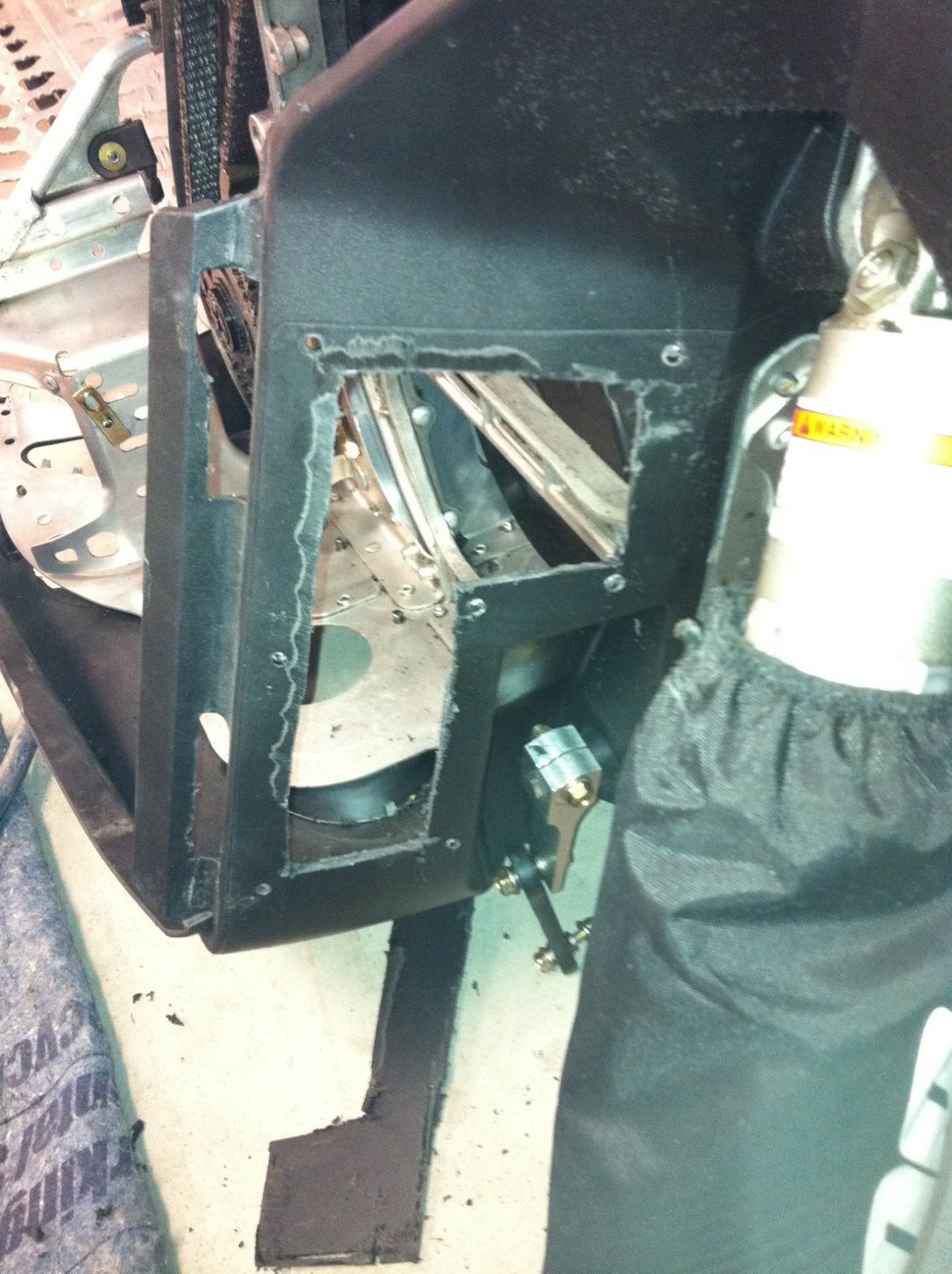

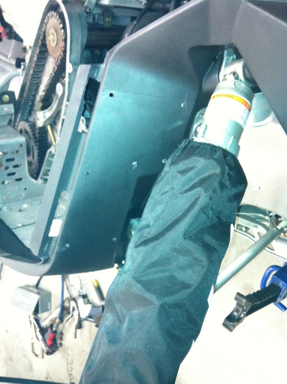

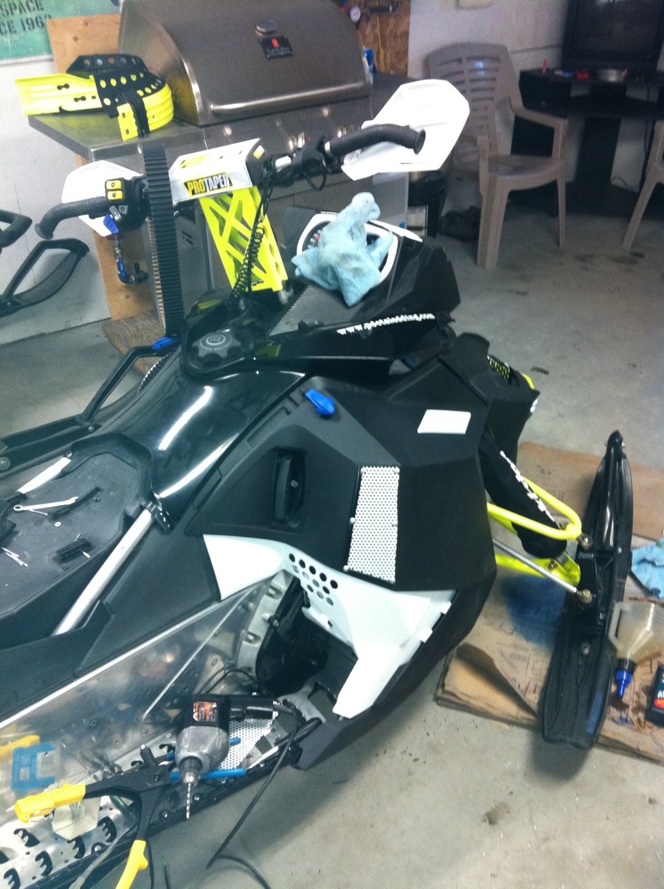

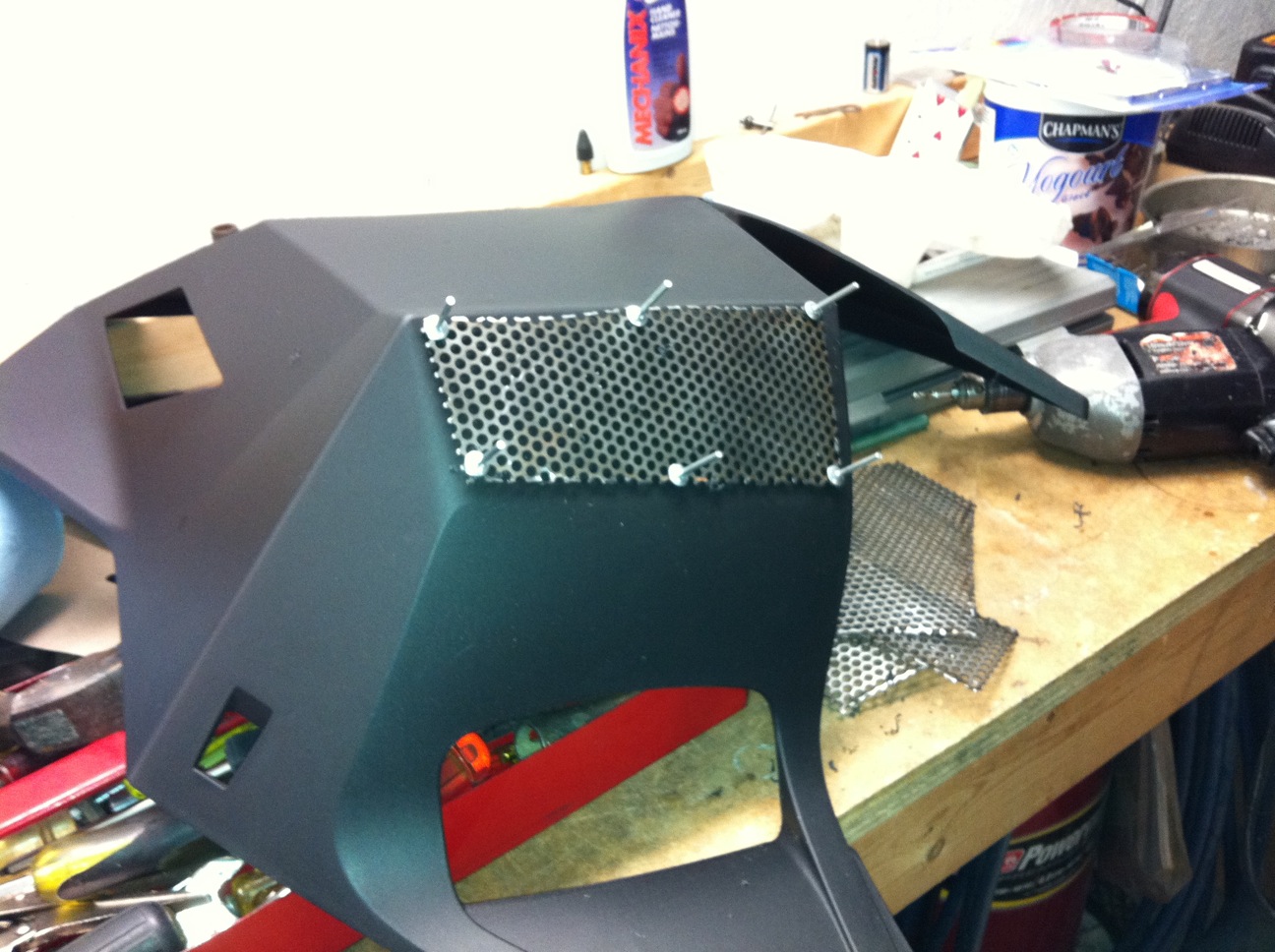

I made my own for my XP a couple years ago. I used perforated steel plate (aluminum is better but I got steel for free) that I cut to shape and had powdercoated, put screendoor material behind it and riveted it to the panels. I want to do the same with my Nytro but it'll be harder to curve the metal since it doesn't have straight lines like the XP.

How well do those frogzskins stick to the rough plastic on the Nytro's. I have some aluminum ones built for the panels just behind the shocks. PITA to curve and make fit but I think they will look good in the end. Need to get some flo rite material or frogzskin to cover that also.
tapp1
nitris223 said:How well do those frogzskins stick to the rough plastic on the Nytro's. I have some aluminum ones built for the panels just behind the shocks. PITA to curve and make fit but I think they will look good in the end. Need to get some flo rite material or frogzskin to cover that also.
They adhesive is extremely sticky. You really only have one shot to get it right. I was surprised. I did prep the area to remove any oils/dirt/wax. I also warmed the plastic with a heat gun since I was applying this in my garage.
