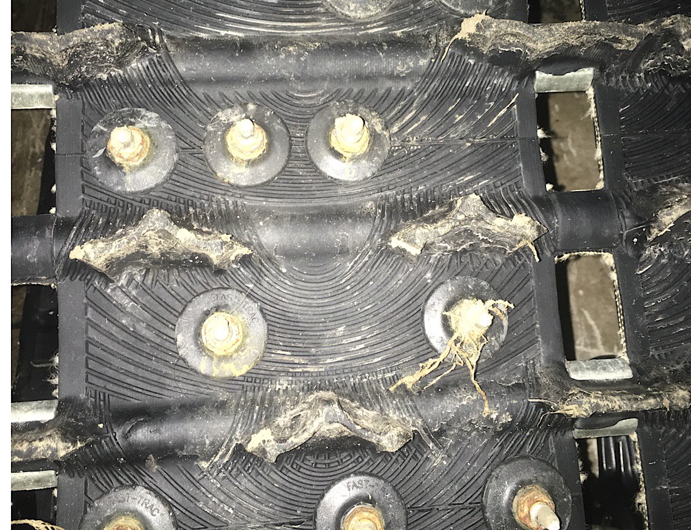

This what my dealer did with mine when brand new. I have over 8k on this track and studs with no pulls. The pattern is very staggered and only in Center.
Do you know how many studs total? I have 144 on my 16 DX with a 1.25 and it still gets loose on ice and occasionally on trails if pushing it.
I don’t now the exact number but was told it was the max that they recommended with a angled tip to reduce bearing wear in skid. Yes sometimes it still gets loose in certain conditions but not that often.
Questioned there theory but 8k later.
No pulls, original tri hub bearings, 4th wheel bearings, wheels, hyfax. Only bearings that have been changed at 6k was the upper wheel bearings next to torsion springs.
