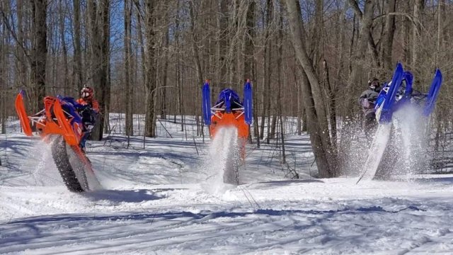

Here's 3 Vipers doing the impossible!

How are those Vipers set up, and what are they?XTX?View attachment 150572
Here's 3 Vipers doing the impossible!It's all about set up and traction. SnoNinja sums it up best on the first page of this thread.

Set up and traction are key but power is also important, 2 of those are turbo and one has the Evo stage 4 flash if I'm not mistaken
All set up differently. 2 MTXs and 1 LTX in the picture but the XTXs like Murdered141 can do the same. Come to the next TY ride , you won't regret it

Plus these guys know how to ride!

I have a 2017 Sr Viper Xtx and it does not Wheelie like all you guys say.
Your stock XTX can do the same as the 3 sleds pictured above. Suspension is key.
I ride with all these guys above and was always called mr. show off....LOL
Set your suspension up like this (guessing you have floats front and rear)
fronts 68 psi
center spring shock, pretty much full adjusted up with stock spring
rear float 115 psi (can try 105psi and play with it off trail)
