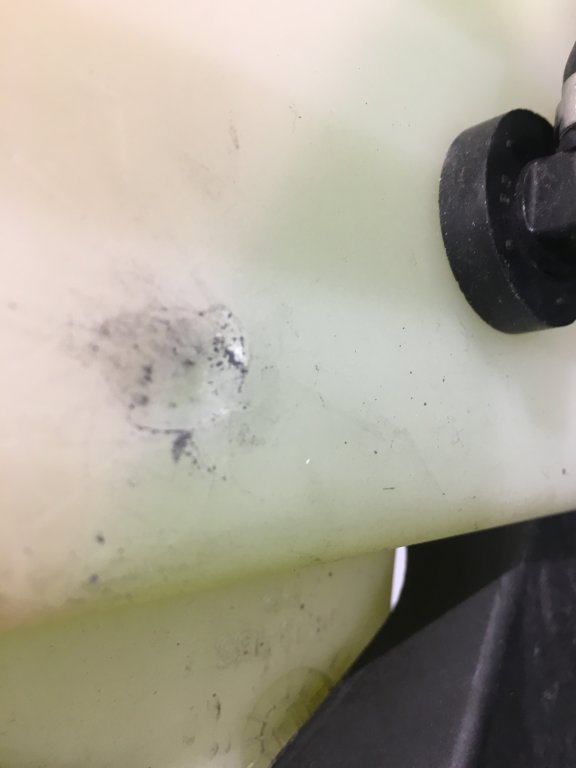

Just an FYI for you guys running the Hurricane intercoolers. The bar the intercooler lays on beats the backside of intercooler up pretty bad and I have spots that are worn substantially. I couldn’t get the pic of the intercooler to download but you can see the bar is worn pretty good. For now I have the bar wrapped with rubber splicing tape but next off season I will weld a mounting point to the bottom of the intercooler to hold it from hitting the bar. Also my coolant tank almost rubbed a hole through as you can see.
Not sure of my fix for this yet.

Well no more rubbing on the intercooler since wrapping the cross bar with rubber splicing tape but I did have the throttle body boots pop off the motor. Crazy I know, the intercooler has no mounting points, it held in place buy the boots only. In rough trails this can cause the intercooler to bounce. This eventually caused the entire throttle body and intercooler to pop off the motor. My remedy for now is strap the intercooler down with wire ties until I can fab up a mount to the frame.

I also had to cut the corner off the intercooler and re-weld a piece. It had almost rubbed a hole through the coolant tank.
