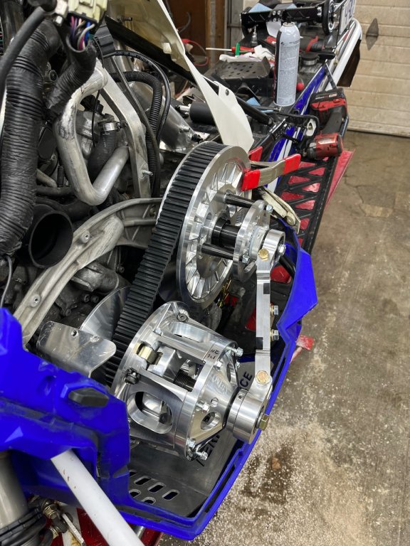

I've tested with and without a brace between primary & secondary, back to back runs, that's not where the majority of the loss is at.

Would you recommend the brace for big power? 500hpish? Solid motor mounts are required as well aren't they?I've tested with and without a brace between primary & secondary, back to back runs, that's not where the majority of the loss is at.
Brace, absolutely. I've never ran solid mounts.
