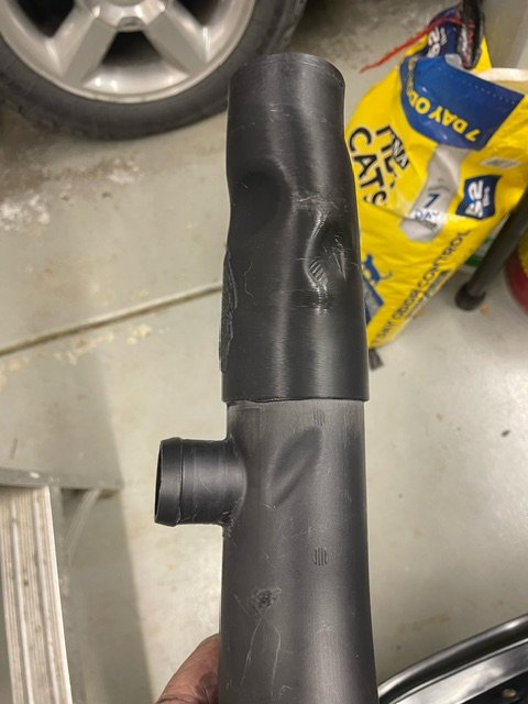

Does it need a second hose clamp compared to stock? One to keep the silicone tube holding on this new plastic intake tube and a second clamp to hold it to the turbo side?

I used the original clamp on the turbo side and added a second clamp on the intake side (so two clamps on the silicone coupler) but didn’t crank it down very tight I didn't want to distort or break the plastic extension tubeDoes it need a second hose clamp compared to stock? One to keep the silicone tube holding on this new plastic intake tube and a second clamp to hold it to the turbo side?
It's a nice tight fit. It's on the intake side so just a light bead of silicone if anything on the coupling to the original intake tube

Anyone else seeing this. The coolant hose / fitting above the intake tube seems to be interfering with the turbo inlet. I was worried it may rub thru. I ended up heating it up with a heat gun and molding a dent in the inlet for clearance. Gonna keep an eye on it.
