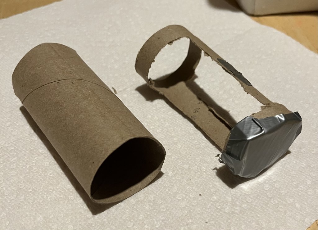

Finally got a free second to build you a 1st grader level project of what I mean by “capping” off air flow. Just imagine the entire toilet paper roll (end of intake piping) being inside of the filter, the capped end will keep air from being “rammed” in. But sides being all open allow air to be drawn in freely. Just an ideaVery functional simple approach, yet still blocks cold air for clutches & belt. Capping air flow, I don't quite understand.

Finally got a free second to build you a 1st grader level project of what I mean by “capping” off air flow. Just imagine the entire toilet paper roll (end of intake piping) being inside of the filter, the capped end will keep air from being “rammed” in. But sides being all open allow air to be drawn in freely. Just an idea View attachment 170428View attachment 170429
I understand. And brought up rerouting a turbo inlet into the engine compartment to others. But we are both met with the same problem in that we're taking in warm air.
And I'm being 100% honest when I say Cai, Wai or whatever you want to call it, it's not a deal breaker for most guys under 280+/-.
There's a lot of guys still running the stock housing at that level (285+/-)
I'm still a huge fan of the gap ram air. Even though I know it's exact worth. (Very little)
Just need to figure out how to reroute cold air to the clutches.
Which a good starting point is described earlier in this thread.
