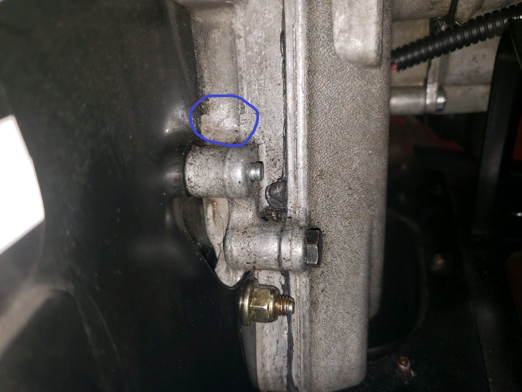

for cracked cases...Anthony Kolenko (sw mich) welds the damaged cases fyi

Partzilla. Inner chaincase assy with bearings and seals installed and adjuster.
$227
That would be cheaper than paying someone to weld it and changing out bearings and seals myself.
$227

Knowing you, I assume all bolts were tight including the ones that go into case from tunnel side?And a 1/2.

The 2 bolts with nuts on the aft side were found to be loose after it cracked. The thread in bolts from tunnel were tight.Knowing you, I assume all bolts were tight including the ones that go into case from tunnel side?
They were all tight last time I checked them.
Never thought I would say its the lack of maintenance on my own stuff.

I check all those bolts and nuts at least every season and sometimes each time I adjust chain. Can't see how it's possible but sometimes 1 or more needs a bit of tightening.The 2 bolts with nuts on the aft side were found to be loose after it cracked. The thread in bolts from tunnel were tight.

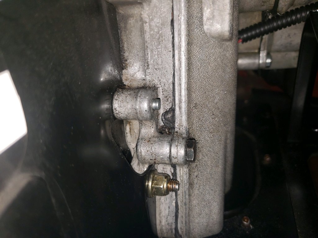

Crack on inside of case is about 2 inches long.

They need a real aluminum chaincase, not this BS magnesium

Might be but there are hundreds of thousands of these cases out there that haven't cracked.
