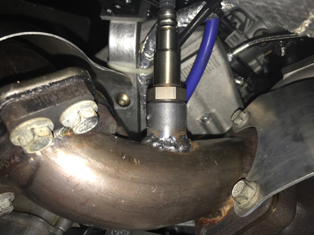

Anyone running an lc2 afr gauge? I haven't gotten it to work for the life of me. I have power and ground, the gauge lights up and the lc2 unit is blinking ready to read. I have calibrated the sensor also. The gauge blinks 7.4 and 22.4 back and forth with no real reading when running. Will jump to 11.4 but always back to 7.4 and 22.4. Never a live reading. I'm welded pre turbo with long bung from innovate. Can anyone tell me what wires from the controller go to the gauge? I have yellow hooked up but I'd doesn't make it clear what wires go from the gauge to the module/ sensor. Frustrating

I have gone through 2 already. Only lasted a few Kms each. I used the MPI bung after the turbo. For my 3rd sensor I am going to try something different, not sure what it is but mounted in the MPI bung after the turbo definitely does not work.My bung is after the turbo. Your saying weld one in before?

I believe that bung is too shallow. It puts the sensor out in the exhaust stream too much. Welding a deep bung in the mid pipe seems to be the fix.I have gone through 2 already. Only lasted a few Kms each. I used the MPI bung after the turbo. For my 3rd sensor I am going to try something different, not sure what it is but mounted in the MPI bung after the turbo definitely does not work.

I wonder if I weld that Bung that came with the gauges on top of the MPI bung, if that would take it out of the stream enough? Ya think?I believe that bung is too shallow. It puts the sensor out in the exhaust stream too much. Welding a deep bung in the mid pipe seems to be the fix.

Maybe.
I removed the mid pipe and welded the bung in up there. Worked real well and not hard to remove.
