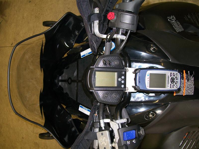

What is the best way to cut up your plastic panel to install the roest vent kit. They say use a small hacksaw. But I don't see how you would get a clean cut around those curves. I like everything to look clean and good. Any suggestions would be great.
I used a dremel with a 1" cut off blade. Work very nice ~ the slower the better.
towerrigger
Box cutter knife like a Olfa brand knife. Make several passes following a marked line.
vent kit
I used a stanley knife,but I heated the blade and it cut like butter.Go slow and it does a great job.
Sledboy04
Measure 3X and go for it! It's pretty easy, take your time and go slow- I used a box cutter and finished the edges with a die grinder. Looks great.
Sledboy04
Mountaintech
Lots of good replies. The biggest advantage is to go slow which ever method you use. The hacksaw blade actually works quite well, but was only a suggestion. (although thats what I use)
Peter I couldnt find a handle like you had and a rag was not good to the hand. So I grab the dremel.
Mountaintech
bottlerocket said:Peter I couldnt find a handle like you had and a rag was not good to the hand. So I grab the dremel.
Hey man, whatever works! I didn't even think about the Dremel tool I have sitting in a drawer. That's what makes these forums great......sharing the info.
nytro addict
Thanks for all the suggestions.
Sounds like the box knife wins. I'll give it a try this weekend.
