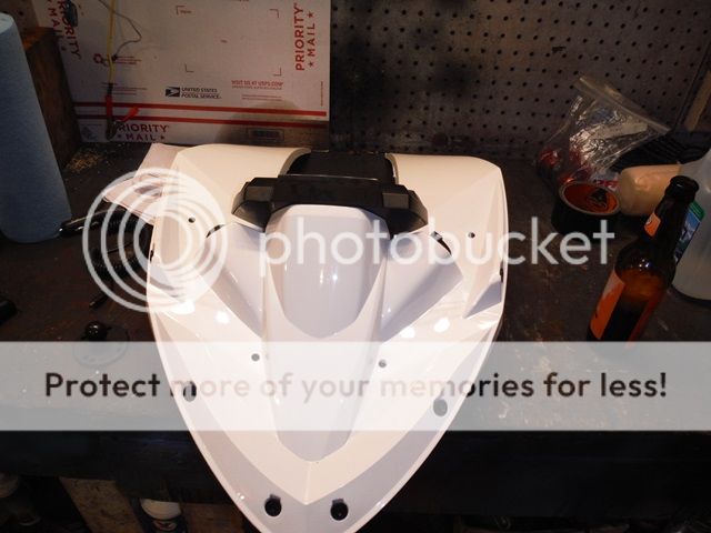

How difficult is it to remove the instrument panel from the Viper? I want to mount a gps but have to get under the those black pieces of plastic that run right beside the steering post to tighten the bolts for the gps mount. I attached a pic for reference.

here is a brake down of the hood when I installed HID headlights: http://www.ty4stroke.com/threads/sr-viper-hid-install-procedure.137676/

Its not hard at all. To get the black piece in your picture off you have to remove the hood. There are two screws at the bottom of the hood and two on the side both by the front bumper. I think there are also two more on the sides under the side panels. Lift it off and the black part is held on by four screws by the gauges and two underneath. I have had mine a apart a bunch of times to install gauges and Power Supply. Take your time and you will be fine.
