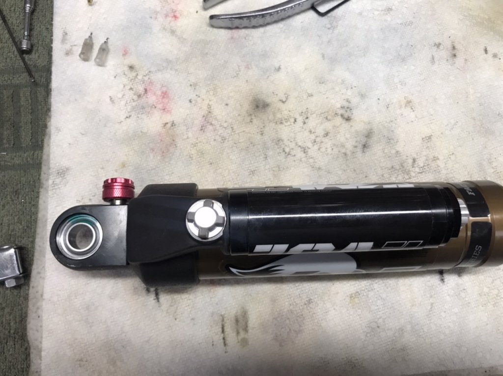

I bought a used QS3 Lockout Rear shock. Air. Wanted to go coil but could not find one and time to get on the Viper. I did install tunnel bag today on Venom. 2 more holes drilled in new sled! I like it. Lot of room for jacket or food. 2 holes drilled in tunnel plenty of clearance for heat exchanger.

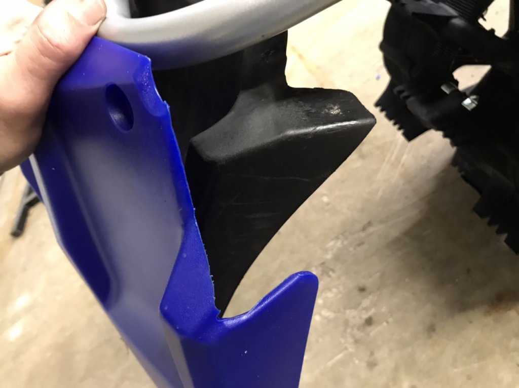

Rear SnowFlap
I really like the simple tube bumper and the fact whole back is clear for a Stand to go right in middle. They also went from rivets which were on the Demos to screws. Both improvements but based on the movement I am seeing and is shown in video its not going to last. I will go back to the flap which attaches to bumper and tunnel to eliminate the flex. Down the road I will get a nice rubber flap like my Phazer has.

As the tunnel is one off , it would appear that aftermarket tube running boards would need extensive rework to fit up properly you figure? One of my pet peeves is slippery footing and snow build up.
The shocks in skid are exactly same length and travel as the Alphas. The Ski shocks are the exact same length and travel as any M or Yamaha with 38" front. Yes the Running boards are probably not going to work aftermarket but if your doing that it wouldnt be a big deal to modify them to work. The width is same as Alpha. Would just have to use the toe loop and brace at back I am thinking. Neighbor has a Alpha so will do some measuring sometime. Would be a very stout setup since the skid drop down brackets on the Venom are way shorter and reinforced.So you are planning on using the Floats on front end off of the alphas? These will be a direct bolt on? Would rear be same? I thought they had less travel.
Hey are those snowbikes yours? If so Cool! Always wanted to rip on one!So you are planning on using the Floats on front end off of the alphas? These will be a direct bolt on? Would rear be same? I thought they had less travel.

More to add. These were advertised as off a 38” but Don’t match specs I have but was a great deal and look new. I will have to shorten them slightly. Easy job and will do refresh anyway. Sweet!
Turns out they are 40" M shocks. My Fault should have looked better. 38" is whats needed. I can fix though.
