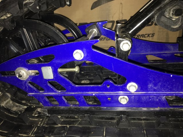

The LTX has an 8" OEM size wheel. The coupling bar (Shaft, Pivot 8JP-G7337-00-00) is the same on the RTX and the LTX. The only differences I could find were the size of the wheels and the location of the Pivot Shaft with respect to the rail tip. The photos are of a stock RTX-SE with Tri-Hub with black rail. The LTX-LE is stock with Tri-Hub with blue rail.The stock bar works- has about 1/8" clearance with 1" sag on the track

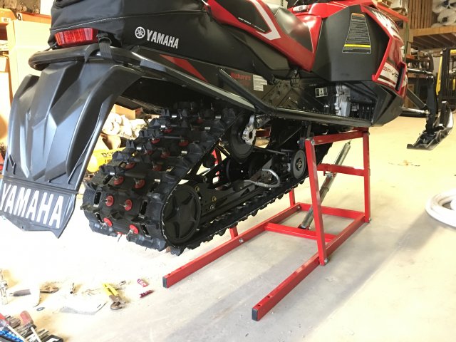

Just finished installing the J&T Stealth big wheel kit on my Ltx Dx. Pulled the skid and greased all the idler wheels and all zerks while it was out. All went very well other needing my buddy's help getting the skid back up in the front shaft. Wheel kit is a nice fit and looks sweet. Will do my wives Rtx se next weekend.
