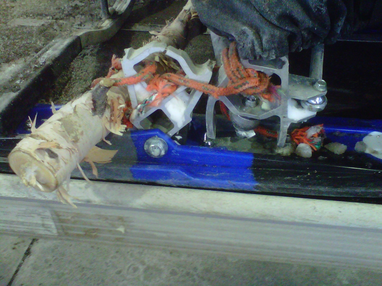

I agree 100% about the extra gusseting being the fix for these subframes. I installed one of Grizztracks kits this summer as well as some extra plating I made up. First ride out this season I hit a rock at about 35mph on a bit of an angle. Broke my spindle in half, bent my lower a-arm up, bent the lower a-arms mounting bolts, bent the ski mounting bolt in the spindle and even bent my 6" studboy shaper carbide, but my subframe is still as straight as when I put it back in this summer.
Here are some pics of the damage to show how hard of a hit it was:

moab11 said:I agree 100% about the extra gusseting being the fix for these subframes. I installed one of Grizztracks kits this summer as well as some extra plating I made up. First ride out this season I hit a rock at about 35mph on a bit of an angle. Broke my spindle in half, bent my lower a-arm up, bent the lower a-arms mounting bolts, bent the ski mounting bolt in the spindle and even bent my 6" studboy shaper carbide, but my subframe is still as straight as when I put it back in this summer.
You limped the sled back with the spindle sections tied together?
One word...awesome!

Grimm, yep, limped it out with the spindles tied together and a log from one side to the other to help keep the ski straight. It certainly wasn't ideal and was far from fun riding back out, but it was better than leaving it in the middle of nowhere.
WNY PAT, I bent my subframe last year on a MUCH smaller hit and my shock spring was rubbing the a-arm. I think much more and I would have damaged the shock. Also I was able to pick up a complete set of a-arms and spindles in great condition for a little over $400, try finding a subframe for that much shipped. No damage is ideal, and that was one serious hit, like I said it stopped me from about 35mph in 20ft or less, something had to give.
