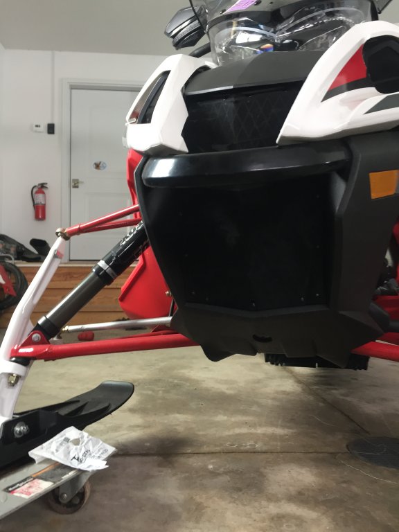

http://www.frogzskin.com/index.php?main_page=product_info&cPath=34_45&products_id=158
Is this what people are ordering for the covering? Not sure how folks are attaching it. Can we get someone to post a picture of how the screen and frogskinz are put together?
WINDER1987
Im also wondering thishttp://www.frogzskin.com/index.php?main_page=product_info&cPath=34_45&products_id=158
Soupy
- Jan 10, 2017
- 359
- 84
- 668
- West Michigan
- 2017 Sidewinder LTX-LE
That's what I used, works well. Riveted it to the cat grille. Little tricky getting it tight & flat. Keeps snow out of intercooler which I assume keeps intake temps lower but I didn't compare before & after. I hated seeing an air to air intercooler completely clogged and not letting any ambient flow over it.Im also wondering this

Nice work I was just thinking about do this to mine but with the yamaha grillView attachment 126365 Ditch banged with my frog skinned front cat grill today for an hour hitting every drift in sight and there is zero snow on the grill works perfectly I will have more testing off trail this weekend but this looks to be the ticket!
