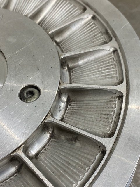

I had an STM on my 1100 turbo and also experienced the same cracking. Needed to replace it. Also had to replace bushings every year on the sheaves.
My Team secondary has been way more reliable on my xf9000 surprisingly! 18000kms trouble free at 270hp.
If I wanted an aftermarket secondary again it definitely wouldn't be an STM....

I’ve never had issues with the old button clutches other than breaking to many belts trying to get it dialed in lol lots of guys using them on there sidewinder I have an almost brand new one if my race sled it’s a viper secondary but I like the back shift of the roller clutch.Clutchmaster and I don't buy it either. Its just plain not strong enough to go miles on a turbo trail sled with the heat cycles up and down involved.
There are no complaints of the Pro-4 cracking anywhere and thus the reason for him going that route. We'll see how that one holds, but its thicker where it needs to be in this area too compared to the STM he claims.
I see some reports of the stock Winder secondaries cracking as well, I'd guess from the same heat cycle problems. I'm sure any clutch could come apart but I don't recall many old style button Yamaha secondaries cracking do you Ernie?

I am looking forward to the new TAPP secondary when it is released. I am sure it will be as well built as their primary clutch.A public service announcement brought to you by Clutchmaster, who we haven seen here in a while, which really bums me out... He is a wealth of information!
Clutchmaster just purchased my Pro-4 secondary to replace his STM secondary that cracked. He sent me pics of cracks in the webbing on the STM.
It sounds as though that this is a reoccurring theme with the STM secondary. He mentioned STM claims the Yamaha "triple harmonics" are to blame. Clutchmaster said his STM secondary has only 3500 miles on it and has never blown a belt with it installed. He thinks the heat cycling, thin sheaves and thin webbing are to blame, for the cracking, not harmonics. He has run on the 270 tune 90% of the time for those 3500 miles.
He has the Pro-4 in his hands and has measured the webbing to be thicker on the Pro-4 along with the sheave thickness to be thicker, not to mention the Pro-4 has more webbing in it than the STM does too.
He googled the cracks on STM & there's also cracking reports on the 1100 Cat twins and Ski-Doo triples as well, so this appears to be a more common theme than just the Yamaha triple engines. Keep a close eye on them! Just because there billet, doesn't mean they won't crack.
