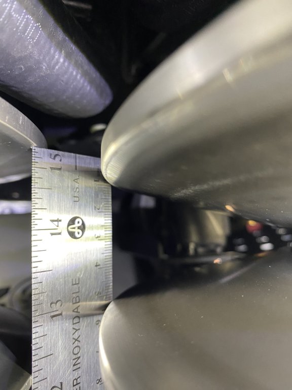

soo i like to measure from inside peek of primary sheave where belt rides to outer peek of secondary sheave where belt rides, this eliminates sheave thickness variances amongst different clutch manufacturers..... if you run a XS825 belt, its 52-52.5mm peek to peek, for xs829/827 belt its 53-53.5mm....
Every man of clutch may have thicker or thinner sheaves.... this method eliminates all those variables as long as your using same belts as its only concentrating on where belt rides.

Using your method mine measures only 50mm. Haven't had any belt blowing problems but I haven't really beat on it too much. Secondary does get some heat after a pull. Took the beltguard off and ran it up on the stand and eyeballed it as it shifted to the top and the belt looks like its running pretty straight. this is with a pro 4, 3 arm primary and the stock team cat secondary . hard to believe I'd have to shim the secondary out 3mm more. It has a .090 and .030 shim in it now that would have to be doubledsoo i like to measure from inside peek of primary sheave where belt rides to outer peek of secondary sheave where belt rides, this eliminates sheave thickness variances amongst different clutch manufacturers..... if you run a XS825 belt, its 52-52.5mm peek to peek, for xs829/827 belt its 53-53.5mm....

Now that being said, ive got an 8.4" primary and 11.25 sec diameter.... with the taper extending out a little further from centre line.... this might account for the extra 1-2mm, is your aleo for a xs825 yamaha belt... because it would measure with my bigger set up 52mm, it your 3 arm is 8"and sec is 11" that might explain peek to peek being 50-51mmUsing your method mine measures only 50mm. Haven't had any belt blowing problems but I haven't really beat on it too much. Secondary does get some heat after a pull. Took the beltguard off and ran it up on the stand and eyeballed it as it shifted to the top and the belt looks like its running pretty straight. this is with a pro 4, 3 arm primary and the stock team cat secondary . hard to believe I'd have to shim the secondary out 3mm more. It has a .090 and .030 shim in it now that would have to be doubled

I’ll have to check the dia but it’s a xs827 cat belt , stock cat secondaryNow that being said, ive got an 8.4" primary and 11.25 sec diameter.... with the taper extending out a little further from centre line.... this might account for the extra 1-2mm, is your aleo for a xs825 yamaha belt... because it would measure with my bigger set up 52mm, it your 3 arm is 8"and sec is 11" that might explain peek to peek being 50-51mm

soo heres the measurements i had for PERFECT alignment with stock clutches after using team alignment bar then converging to standard measuremnet bar
From inner sheave @ hub of primary to the outter machined surface of BOSS (old method of measuring)= 1"530=@39mm 0r 52.5mm peek to peek team clutchs
Took team off and placed TAPP on
From inner sheave @ hub of TAPP to outter machined surface of BOSS = 1"550.... so TAPP sits .020 in more on crank.
soo take .020 shim out from BOSS and bring measurement back to 1"530.
now peek to peek with bigger diameter TAPP and BOSS is 53mm or 2.086... so now this extra .5mm would explain the diff in diameter of TAPP is .400 larger.
Now took off BOSS and put the STM on that has slightly larger diameter and also sheave thickness of BOSS is .180 vs STM is .260
Soo to use old style measuring, that would equate to 1.610 hub to outer sec sheave which still came in at 53mm- 53.3mm peek to peek TAPP to STM with slightly larger STM.
