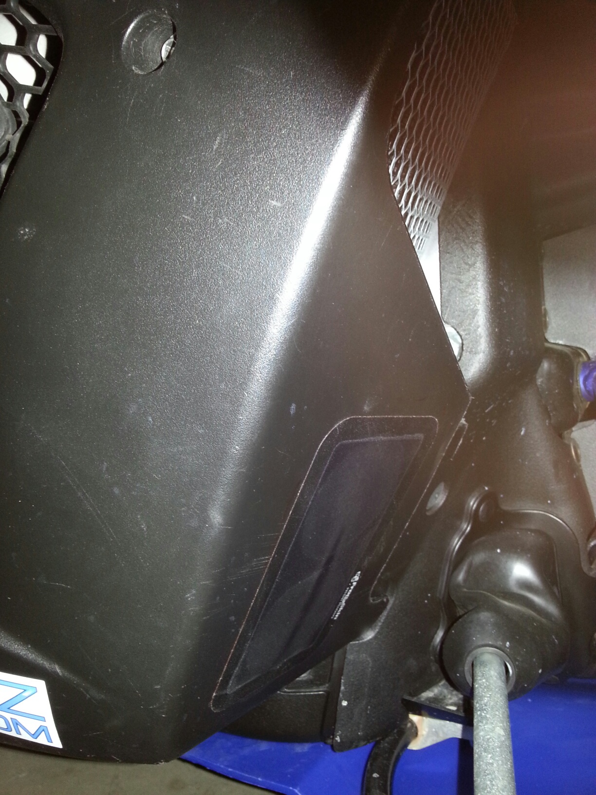

Cubby,
How has your Frogskinz held up to field stubble and brush? Just wondering if it will get torn... Looks nice and functional though
Cubby
- Dec 14, 2009
- 766
- 66
- 928
- South of Winnipeg, Manitoba CANADA
- 2015 Ski Doo 900 ACE Renegade Adrenaline
2007 Yamaha Phazer GT
So far so good - no rips or tears. I was thinking of putting something in front for protection but haven't needed it.
