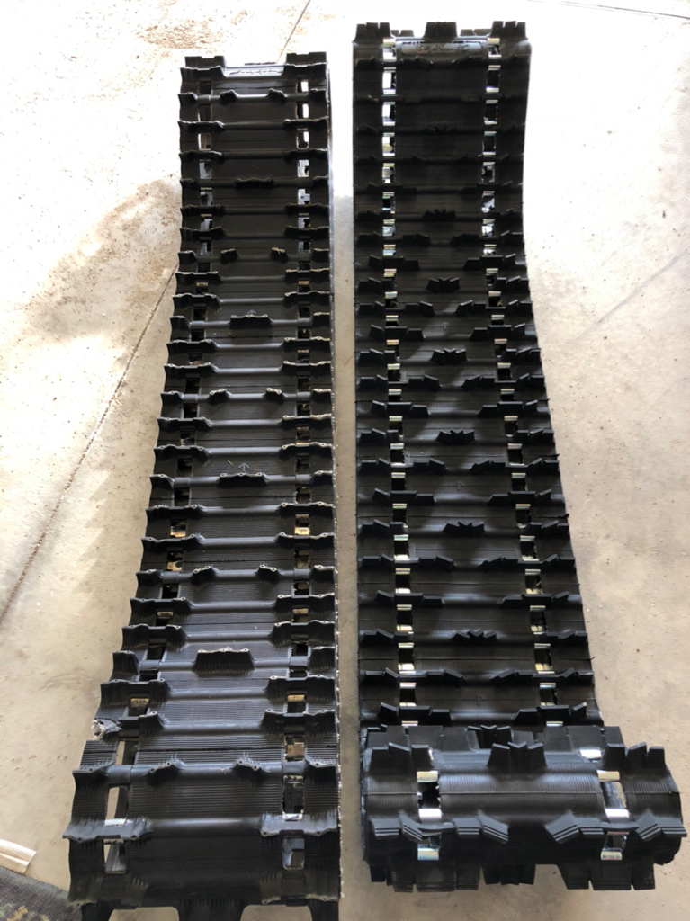

Track came! Out with the old in with the new!

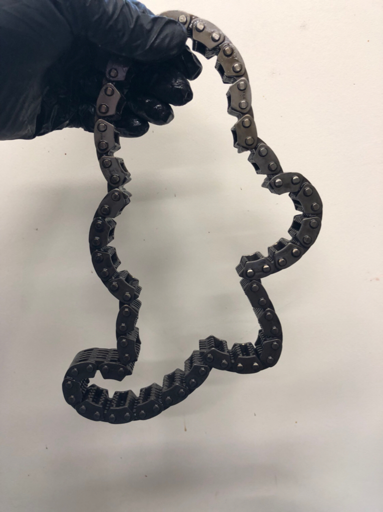

When I pulled the chain case the chain was completely stretched out. This is common in boosted sleds so I always keep a spare. This is what a stretched chain looks like:
That is hanging in the air and it should look like this:

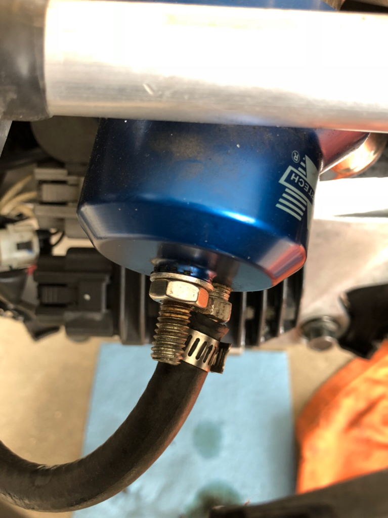

I also got a chance to do some more diagnosing on the turbo. I removed the intake and exhaust so basically just a turbo with nothing attached. As soon as I started it oil and air started pushing out the intake! Which I thought was weird as I was expecting it to suck air. I go up to the vortec BOV and it’s not releasing ANY air which I am used to seeing. I look at the adjustment and it seems like it’s WAY to tight meaning it won’t open without more vacuum. I referenced some old pictures on this site and feel confident I can let it out. The beauty of this BOV is it only takes 1.5” of vacuum to open but when you adjust it down it may take 5-8” to open. So I loosen it and air starts flowing. Back at the turbo it’s no longer pushing oil out into the intake (the actual intake that should only be sucking air) and the turbo stops smoking?!!!?
Here is the valve you can see the rusty part of the threads are what I let out.
I have a new CHRA in the box ready to swap but I’ll cold start tomorrow and see if this fixed it.
