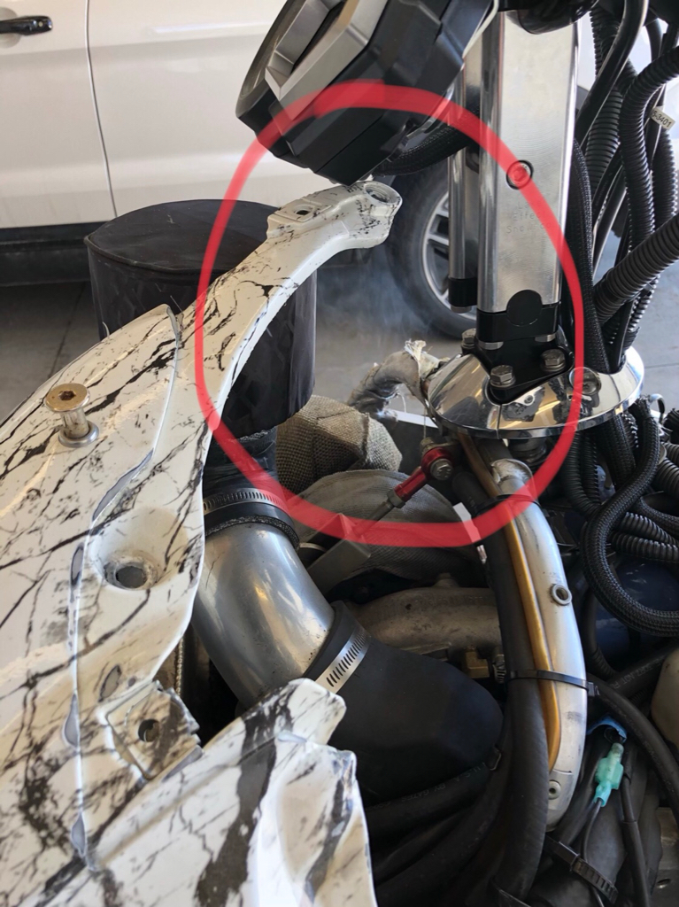

Wiring ugh there is a lot of plumbing with a turbo! I even have coolant going to the external wastegate!
Better:
Relocated XIC I don’t look at it while riding anyway.

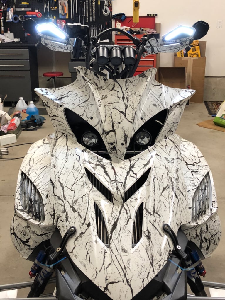

GPS mounted!
The fit and finish is so good, all the panels are tight, and the sled has a nice solid feel to it. Love it all over again!
Just waiting on my pimp LED inserts for my hand guards to complete my LED headlights, taillight and it’s done for this year!
