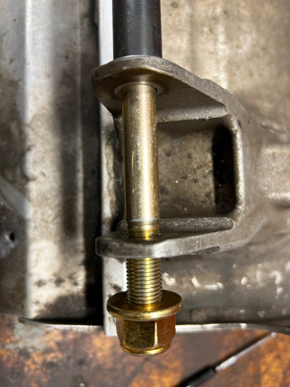

If you had one you know it sucks to replace and could lead to engine damage from overheating. They usually crack at left engine mount where it’s welded to exchanger. Offtrail guys are plagued by this issue but even trail sleds have been afflicted. Mine did it end of last season. I noticed the Sidewinders had an aluminum tube connecting the two mounts and one long bolt vs our two. So I came up with a kit to do the same. Cannondale did same thing to solve issue of engine mounts breaking off. I really believe this will help if not solve. Limited availability. $100 shipped in USA. Murdered you want second one!

What does it take to install this? What's the process and time estimate? I'm interested.

Seat,Shield,Tank and Exhaust header has to be removed and the Jackshaft Spar rotated then each engine mount bolt one at a time with left first. Stick bolt in then remove right bolt. Install tube and washers as you push bolt in. I would say 2hrs. I added Instructions with pics below.What does it take to install this? What's the process and time estimate? I'm interested.

Instructions:
Get spar to this point. Be careful of Brakeline and Wiring. Pulling coolant overflow line out of way first helps make this easy. Of course if chaincase is apart just remove Jackshaft. But not necessary. I left my header on and was easily able to do this with some finesse and extendable magnet. I do not know if able to with stock header. Do not lose the washers/spacers provided. They determine the overall length.
18mm nut and 15mm bolthead remove this nut then using the new long bolt which is lubed very lightly with grease but not on threads gently drive the left bolt out with soft face hammer stop when original bolt falls out. Will fall right out access panel on bottom for changing oil.
At this point remove the right side Engine Mount Bolt. Put one washer(Flat Ground Side Toward Mount) provided on the slightly protruding new bolt then using a magnet fish the spacer in between the Washer and right Mount. Once bolt is in far enough to support spacer tube put other washer(Flat Ground Side toward Mount) in between tube and right hand mount. This is pretty easy since is a ledge around bottom of mount which wont allow washer to fall out. Lightly tap the bolt in till it is protruding about 1/8in out right mount. Using extendable magnet Put some red loctite on nut threads and hold the nut in line with bolt. Start turning bolt clockwise to get nut started on bolt. Then switch to a 18mm open end wrench on nut and Torque Wrench with 15mm socket and extension. Torque to 65FtLbs.
Removing right side nut and bolt using extension and a swivel on socket
Holding the nut with a magnet to get threads started.
Make sure you have clearance with this coolant tube. A good 1/8in. If not reposition the tube
Make sure both washers are still in position. The thickness of both washers and length of tube determines overall length. Do not substitute washers. They can vary big time in thickness. Whole setup is made within .003in so always a set of two washers and tube.
When rotating spar back into position make sure brake line is in this spot.

Nice write up with pics Steve. Getting that torque arm clear is cleaver.
