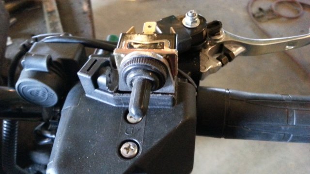

Are you installing your lights and switch on an Apex or a carb Vector? If Apex or EFI Vector, there is an alternative to mounting your switch without having to cut a hole in the dash. There is a thread boss under the left handlebar that is for a choke lever on a carb sled. This is not used on EFI sleds (Apex, Vector) and makes a good mounting point for a switch. All you have to do is move your thumb!I have a lighted led switch i will drill 3/4" hole in a good place on the dash.

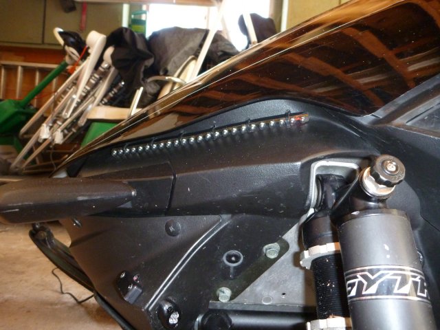

Can you show me the close up of the light facing forward near the front shocks? Without the lights lit. I see a flat spot facing back I think I will use for a small 4 led pod. But didn't think there was a forward facing flat spot.

When you get the lights tape them in place where you think they'll look the best. Run temporary positive & negative wires from any battery and connect them all up. After dark, turn them on and make adjustments to achieve the look you want before permanently attaching.

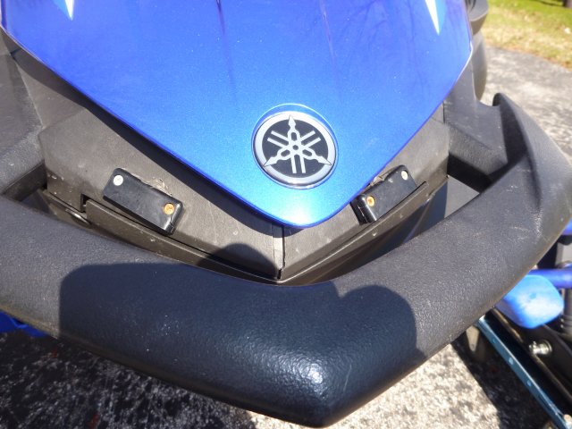

Okay so here are my mounted leds and lighted switch on the dashboard.
Two pods in the shock area facing forward and one facing backwards.
One strip on the nose that will be covered with the upper cowl.
One strong strip in the electronics area to light up through the cowl.
I did tape them in place to see if I liked them first. I did run a in line fuse 5amp atc.
Bitch was grounding them, I used two bolts that are just below the air box and unscrewed them, tucked the grounds and screwed them down.
Seems to work for now, pretty happy with the front now looking towards the rear or under the sled.
So far no drilled holes except the 3/4" hole for the lighted switch on the dashboard. And the tiny ones at the end of the strips.
Sent from my SM-N900V using Tapatalk
