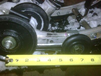

Just measured my MTX, the wheels are ~4.25". I thought they looked bigger than the marginal wheel kit I had on my 99 Vmax. They are small aluminum centers with about 3/4" thick rubber on them. Basically the look just like the older marginal wheels with ALOT thicker rubber on them to make them 4.25" diameter.
Prav you need about 5 1/2 inches center to center on the front set of low snow wheels. The spring will be rubbing the top of the aluminum blocks that mount your low snow wheels

Wow, that's a big difference. No way I could use that wheel as it would pull the track too far from the hyfax. Going from 130mm to 135mm on the other idlers just takes the track off the hyfax but there is a 19mm difference between 3.5" and 4.25". The mounts on your MTX must be different and bring the wheels higher. This setup could be another option to look at instead of the marginal snow kit.

Otter said:Prav you need about 5 1/2 inches center to center on the front set of low snow wheels. The spring will be rubbing the top of the aluminum blocks that mount your low snow wheels
Otter
Just looked. I can see on the mounting block where the torsion spring is slamming the top. I am heading out to move them around now.
Prav
They definitely needed to be moved forward. I can't believe I didn't feel the suspension crunching the top of the mounting blocks. Nice ant-bottom kit I guess. I am going to install the second set up further on the rails beyond the lim strap cross shaft. Should work out nicely.
5.5 inches center to center would of been enough to move the small wheel forward to clear the spring.
