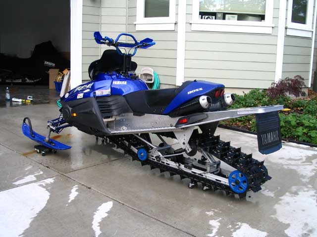

Trxster
I don't have the templates. I just used some cardboard, took a couple of tries. Once I got he approximate shape I tacked it up with the 2 mounting holes and traced the arc for the bolt holes to make sure it was centered on the plate. Pretty easy. Good luck.

Where did you get the Blue Idlers Trxster? Anybody put a M7 141" in a RXM 151" before? I finally have mine all together(M7 skid), polished and ready to install - wondering what to expect when I get it under the sled? Looks like rear brackets could be an issue, little wider than tunnel width.
Trxster
The idlers were actually AC green. I took them off, masked them, and painted with that blue Fusion paint for plastic. We'll see how long they last. I like that the AC skid has big wheels. I do believe a 144" should fit in the 151" track. That was an option I considered but then....I play in the mountains a lot and can use all the float I can get. Let it snow baby!!!
