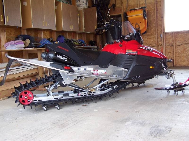

Trxster, Thanks for the feedback. I finally got everything installed and will go out for my 1st ride today. (no pics yet) Probably staying mostly on trail, but I should get a good feel for the new suspension. I did find out why the sled was sitting so low. The rear Shock is not in the correct position. The bottom portion of the shock is on the bottom of the center idler wheels. After looking at several pics, I realized the rear shock should be located on the upper portion of the center idler wheels. I will fix this before going out today. Have a great ride and let us know how the new set up works.
J.
J.
Trxster
Jonny Rocket
- 766
- 893
- Colville, Washington
- 2008 MXC boosted Nitro
Well I finally have the time to post some pics. I would have to agree with Trxster that this AC skid is night an day difference from the pro-action. I only rode trail but this thing rides like a couch. Very nice in the bumps. The rear of the skid is set 2" from the tunnel which seems to be about right for transfer. I set the front limiter strap all the way out and the front shock about 1/3 to 1/2. I set the rear springs to stiff. I will keep it set this way until I get a chance to ride in some real snow. All in all I really like this new skid. Here are a couple pics.
