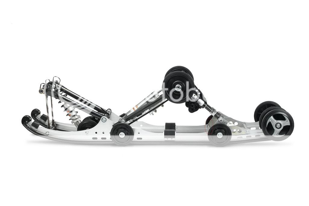

Daranello said:Now that's weird, my sled came from factory with a cross support rod there,
My chassis has the cross shafts at the back too.
But this mod is for wheels on the inside of the rails behind the rear shock lower mounting point.
Have another look at the photo I show at the start of this topic.
I have been looking at shafts etc. near the coupling rods.
But it seems like too much work and clearance will be an issue.
More likely another set of wheels will fit on the outside of the rails near the back.
But that would require a bracket set up for a bolt which needs some more engnieering.
The rail is not tall enough to drill in that area.
Plus when the skid bottoms out..!!!
There is not much room for error on wheel placement.

mach9 said:Daranello said:Now that's weird, my sled came from factory with a cross support rod there,
I see it now, but I'm not getting wear in that area...its all at the back.....love to put wheels on the cross shaft I circled in red!
mach9
Daranello said:I see it now, but I'm not getting wear in that area...its all at the back.....love to put wheels on the cross shaft I circled in red!
I get slider wear at the back too.
But I think less now that I have done this mod.

I added over sized Doo wheels were they were easy to change, then added the mid wheels like mentioned previously in this post (again with oversized wheels) and then I added an extra set 1" behind the rear bump stop and one extra set up in the front of the rails as well.
rhoag
I like what Mach9 did but, with my XTX I wanted the wheels back further. So for 60 bucks I bought a marginal snow wheel kit that is supposed to go on the outside of the rails. Then I machined 2 mm off the spacers and they fit perfect on the inside of the rails. I did test and have 2 big guys compress the suspension all the way and nothing is even close to hitting. The only down side is you have to drill a hole in your rails. I think this will solve my problem with hyfax wear.

Since this did make it into the FAQ.
It's been a full season use on this stock parts mod.
Thought I'd give an update and my opinion.
It did seem to help with less wear showing on sliders around the middle.
Also, I can only assume it helped with less rolling resistance.
Which gives better consistent wear along the slider length back from that area.
I think that more snow is allowed to filter in from the center area going back as you travel.
Not perfect wear at the rear of the skid, but most likely better.
Consider all skids have wear patterns on sliders for any sled brand.
The front curve of the skid is the problem area now.
Too much slider wear at the front before any wheels have a chance to do work.
So much so that I still used 3 sets of sliders by the end of 3000km season.
(One set my fault for running a bunch of ice runs one day and I didn't use ice scratches.)
So in theory, only 2 sets of sliders should have been required for me under average conditions.
Changes for this year 2010 season should fix the above issue.
This year I've added the Yamaha marginal snow wheel kit up front on the curve where the wear is bad and added ice scratches to my skis.
Final thought...
This is a good stock parts mod. It works and nothing failed after 3000km.
Adding more wheels is a good thing unless you are trying to shave off weight.
