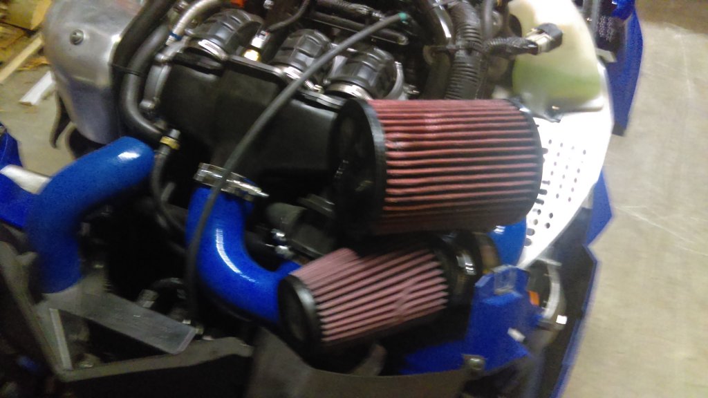

Hi guys,i know some of you have been trying to either make one or buy one,i have had one,but did not like the 5" size on each end,because its size was a tad to big to fit my hood correctly,with out hitting the hood and rubbing on the tubes below,so after some looking through K&N filter lists,i came up with something that fits much better,and wont hit either item mentioned. Special Thanks to Rockerdan for sending the list out so I had easy access.

The new filter is K&N SN-2600 and I used a auto dynasty silicone reducer coupler 2.75 to 3".
