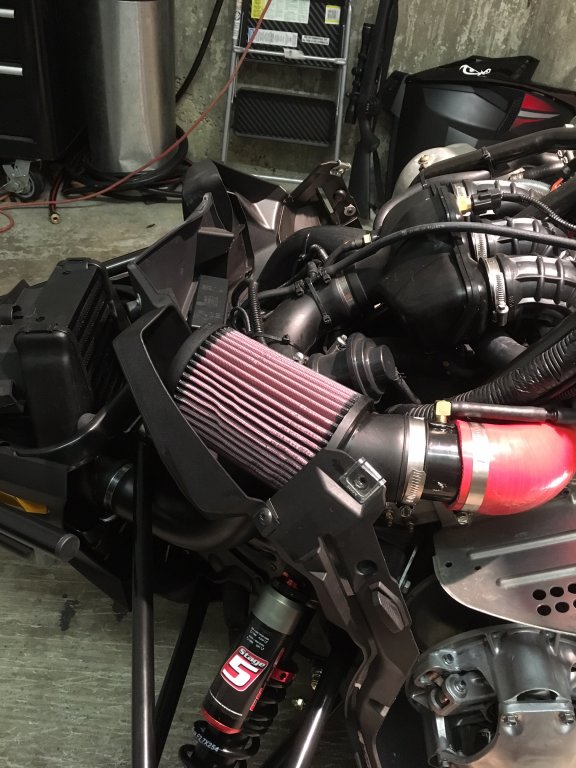

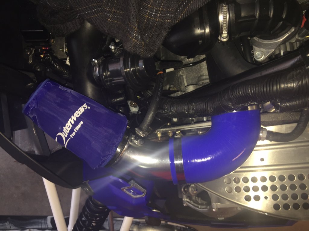

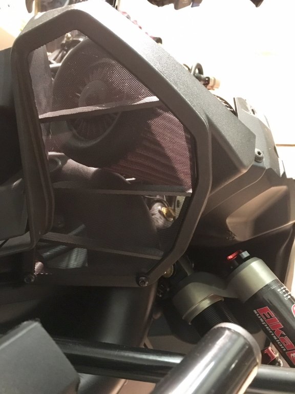

Here is mine
Air filter K&N rx-3800. Pre filter rx-3820-pk.

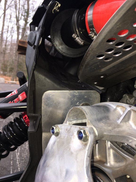

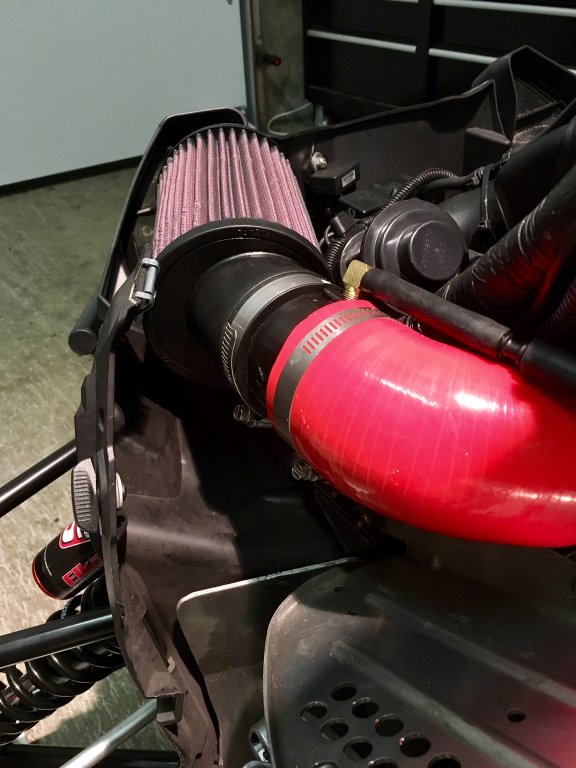

Byam, nice job heres mine came out nice. Really like the fitting made for teflon hoses for the other vacuum line

Byam, nice job heres mine came out nice. Really like the fitting made for teflon hoses for the other vacuum lineView attachment 133423 View attachment 133424
Thanks to Rockerdan for assisting to locate this stuff
