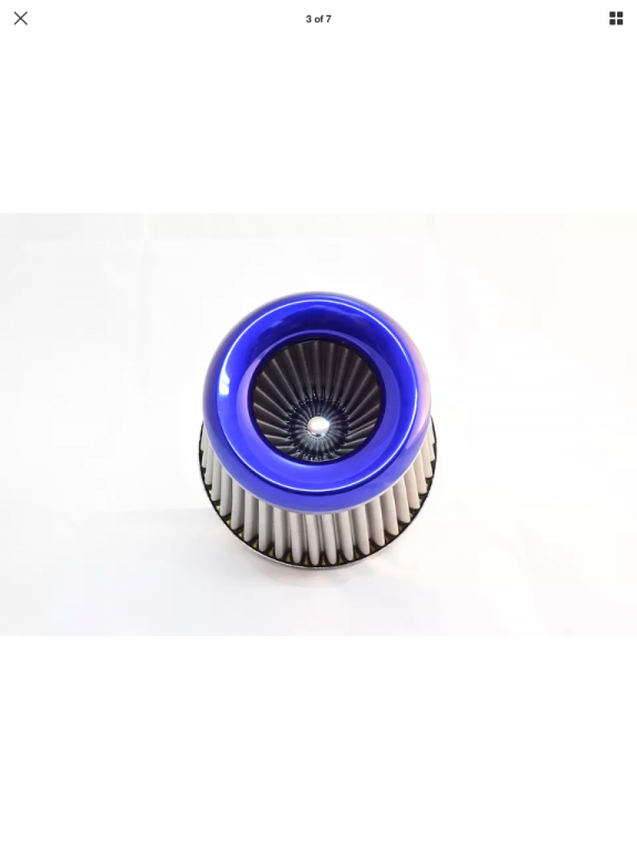

Is this what you mean by open end?

Yes that is open end design, but not a K&N......
there are many non k&n out there, which they say are red gauze type, likely same thing as a k&n and MUCH cheaper, but you just never know what you are getting.
I need to get sled here before I decide specifically which one Im going to order, just want to take actual measurements on my own sled first, so far I have gone off some measurements ive just got off internet. But they all seem to be close.

The one thing I see with the open end vrs my closed end,is it may flow more air and may need more fuel,but I like how it may work better,does someone sell one like it,but have a taper for it? So 3" ID to fit my outlet pipe from turbo,its OD is just under 3" and can is 5" on the end that it clamps onto pipe,and 6" overall length,and what I want on end facing outside will be 3" Dia. so it is tapered.Yes that is open end design, but not a K&N......

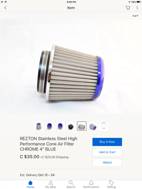

That blue and white filter,who makes it? Is it tapered at one end?Is this what you mean by open end?

I found it on eBay. I'm curious as well if the open end flows more air. Also curious why they are not used in the kits that are offered.

Pete ive posted the link many times, you need to go thru the k&n charts, there are a ton to get whatever you needThe one thing I see with the open end vrs my closed end,is it may flow more air and may need more fuel,but I like how it may work better,does someone sell one like it,but have a taper for it? So 3" ID to fit my outlet pipe from turbo,its OD is just under 3" and can is 5" on the end that it clamps onto pipe,and 6" overall length,and what I want on end facing outside will be 3" Dia. so it is tapered.
IMO the alpha is too large though, cuts off too much airflow to clutches.

Pete,are you new to internet?That blue and white filter,who makes it? Is it tapered at one end?
Go on ebay and search RAM air filter, there are zillions. Internet is pretty cool!
