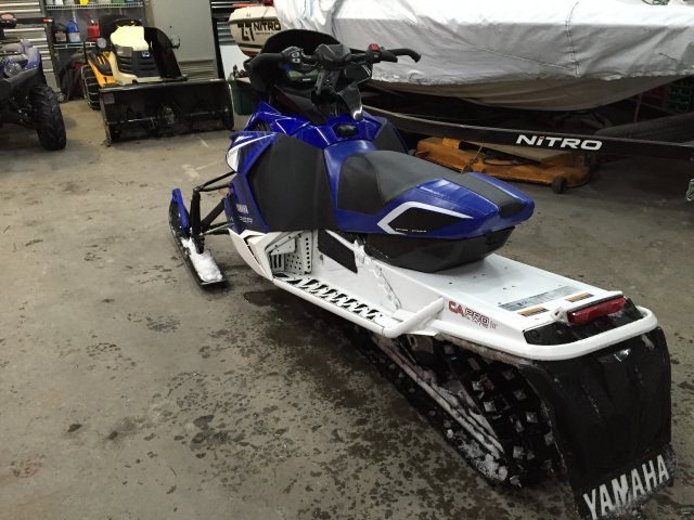

Here are a few pictures of the sled. Seems mostly stock except for the windshield and the track studs. The areas of damage are very minor and can't really be seen in these photos but they still bother me. I will post some more pictures this evening.

Nice looking sled ya got there. Looks pretty good to me but I under stand making it yours. Add a nice bumper, add a tunnel wrap, fix the vents and cracks, clean the clutches, maybe give it an oil change and some grease, and ride the snot out of it.

Very sharp machine. Clean the battery terminals, install a tender, and keep it plugged in. Then, it will be ready when you are. Enjoy!

Oh Boy I will put it on the line Nytro. I cant tell you to run it as is even though I spent the first 600-1000mi almost completely stock and will never forget how happy I was to have that exact same sled and how much I enjoyed those rides 3 years and over 7000mi ago. I see it is aggressively studded. I also see you have a CA Pro sticker on it. I believe you will either need to remove the sticker and studs or get CA Pro skis. It will not turn in loose snow if you dont. Next I would have the rear shocks revalved or at least the rear rear shock. I can help you with that and it is a amazing difference. I am assuming they are stock shocks in there but I cant see them in your pics. Skidplate. Buy a factory Yamaha skidplate. I regret not doing that first thing since I damaged my sled without it. Thats it for now. Up to you to see what else you want to do. In my opinion nothing more is needed. Above all ride it every chance you can!

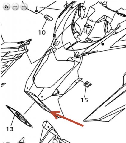

As I don't know all of the parts off the top of my head here is the best representation I can give for this issue. The part that is cracked is the very front piece to keep the front part of the hood/ shroud from moving around. In my case it is cracked from the top left to the right bottom. best guess is it is about a 6 inch diagonal crack. To me it seems that it is about one solid jolt from cracking completely.
