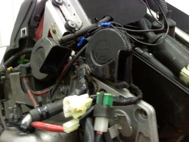

2008FxNytro said:
i believe its the green housing in the pic....correct me if im wrong.
Thats the main fuse. If you want some security when leaving your sled outside at night. Get one of these and make it blow, then just take the good one out and put the blown one in.. Its not going to start with that fuse blown! Its easy to get to, and I would be very suprised if someone jacking your sled would be able to find it!
