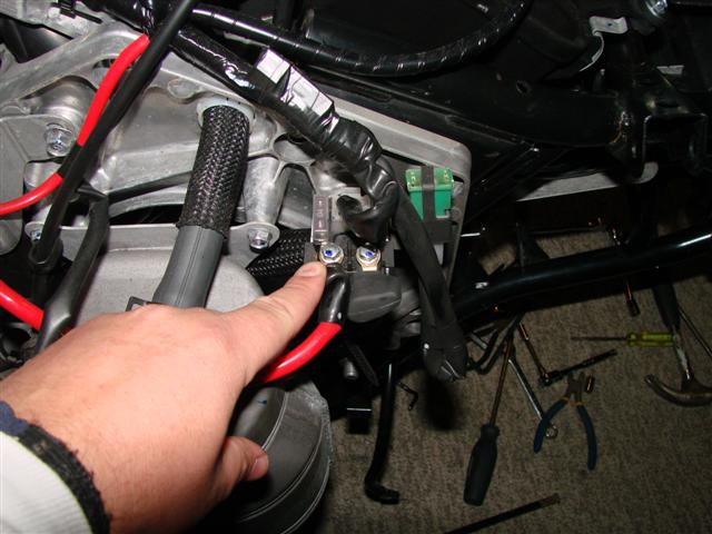

Relay is really quick to check. Jump across the bolt heads in the pic.

Went out there tonight & jumped across the two bolts on the start relay & she fired right up!!! I can't believe that went bad just sitting in the garage. I haven't even had a chance to ride the sled yet!!! Is that a common problem?? Well thanks again guys for all the help,i really appreciated it!!!! Art
its a very common problem, get a new updated one (i dont know the item number) install it and put some dielectric grease on the posts, and it shouldnt cause you problems again.
yup dielectric grease everything all connectors and relay's.keep battery connections clean too.
