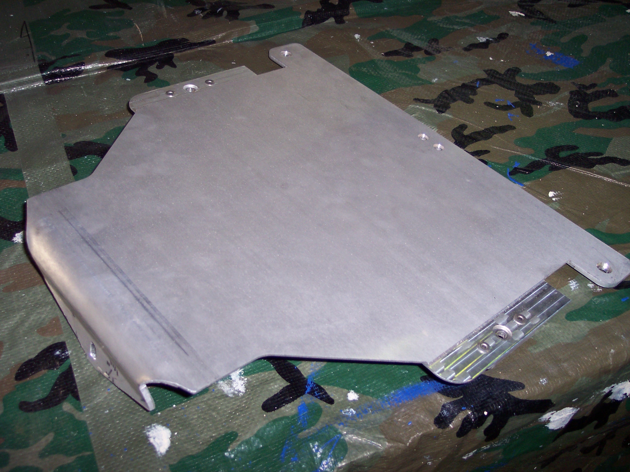

I bring my sled inside to thaw out. If you don't, ice will build up and stay in places like the subframe, tunnel, rear skid, running boards, nose of the sled etc. I will soon be releasing a shorty skid plate that is almost an exact copy of the OEM "engine protector". It will be constructed of 3/16" aluminum and attached with stainless fasteners to protect the sump of the engine and heat exchanger like the one you have now, but does not offer the full length protection of the full length skid plate. I will continue to run the full length one on my personal sled as I think the full length protection is the best.
