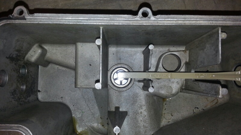

yamahaguy
Ride SAFE
- Apr 20, 2014
- 1,405
- 1,557
- 2015 Yamaha MTX LE with MPI
If you put a dipstick into the sight glass oil tank here's what you're going to get. The oil will just barely touch the tip of the stick when the oil is 1/2 way in the sight glass. I hope this helps.
klondike22
- Mar 4, 2013
- 66
- 708
- northern New York
- 15 SR Viper LTX SE
Great! The pic really shows what I was interested in knowing...thank you! I can get a cap with the dipstick and re-mark it so I don't overfill and will be easier for me to see. (old eyes don't see very good at close range with the sight glass). I have been having issues overfilling and blowing into the air box. Messy to say the least.
