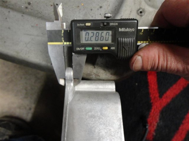

I know the chaincase was updated on the 15.5's. Looks like all different shocks on 16's so thats good.

Is it still a cat chaincase?
Yes but they made the tabs thicker so they dont break off so easily.

What are the tabs? Are these what are causing some chaincases to grenade?

mounting tabs on some were cracking. Not all of us have chaincase issues. Mine worked flawless before and after the update.

I'm still a little confused on what these mounting tabs are...
Its the tabs where all the bolts go that hold the chaincase cover on.

Oh ok, thanks. So I'm guessing if the tabs break off, the cover will fall off causing a wonderful mess...
Here you go. This is a updated cover.
