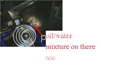

Just got some pics. Wow. Somethin aint right.

I just bought one off eBay.. Could be skinz but I don't know. Also, I installed UP Bushman's bushing kit to cure the yamaslop this weekend, could I have put something back together wrong? Mind you I DID NOT remove the airbox. I simply went in from the front where the tool bag is.

my guess is thats where the snow is getting in. yeh thats the yami skid plate, skinz is wide front to back, doesn't have huge cut out for a arms
Phazer500
Found that greasy mixture on there too. Don't know if it means anything I'm just trying to post all the pics I can to get down to this.

you didn't overfill the oil did you? maybe causing it to blow out the overflow & leak out on everything. not that this is your bog problem.
do you know if it's coming in from under the filter or leaking through the gasket on the airbox?
maybe the airbox lid wasn't on properly?

all the oil mixture you see is just water coming out of the airbox - looks like the airbox is doing it's job keeping the snow out of the motor - i had an 07 and would absolutely bury it in the deep snow and it never bogged -

I think that skidplate is acting like a shovel.Try taking it off and run stock or buy the glideplate like said.
