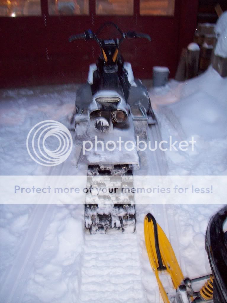

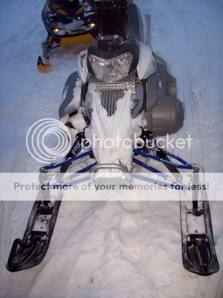

It's about time for an update so here goes, I pulled an all nighter on sat. night and went riding on sunday and this thing is fuckin amazing! I rode a mcx turbo phazer that someone else had built and it was nothing compared to this. My engagement is @ 6900 and I don't bounce off the rev limiter unless I'm on a road or trail where it can spin. The turbo lag that I felt on the other tazer is non existent on this sled. I could go on all day but I'll just post some pics.
I am currently running stock engine on 100LL with 9-9.5 lbs of boost

looks nice what elevation u running i looking for some help clutching for around 10000 ft
ak
looks good man I like that exhaust. How did the mnt tamer suspension work out for you? I cant wait I get to ride mine in a week. And no shim equals no lag.
yukonranger
I'm lovin the mtn tamer
less weight plus strong plus adjustabilty = awesome in my books. No headshim is def the way to go

What did you do with the plastic cover that fits right in the front of the sled in front of the engine where the charge tube passes through into the bottom of the intercooler? I left mine off for now but a lot of snow is getting in there.
yukonranger
I cut a hole in it for the charge tube

yukonranger said:
Is that the air filter setup that came with your kit or where did you get that? I am having serious problems in powder.
yukonranger
I built the air intake box myself and the filter in the pic came with the kit. I have put on a larger filter and it's great.
